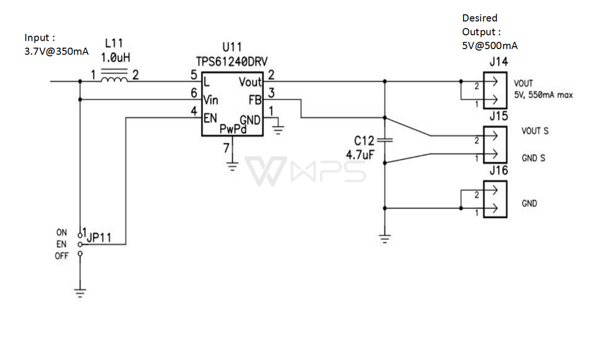

I do have on query on booster TPS61240.
Please find schematic below :
So will i get 5V@500mA output with 3.7V@350mA at input.
