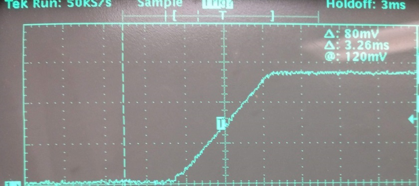

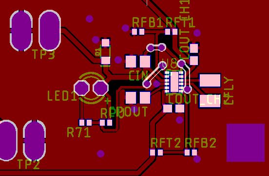

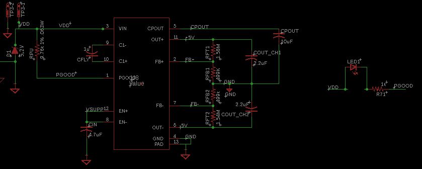

Hi, I am trying to use the LM27762 as a +5 and -5 LDO.
PFA my Schematic and layout.

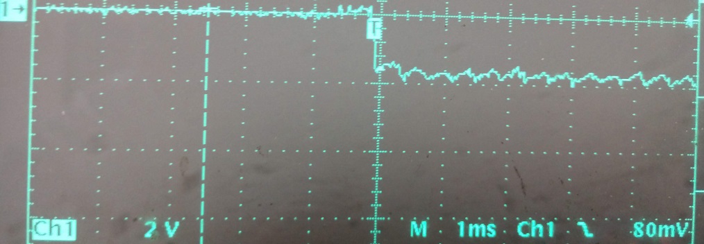

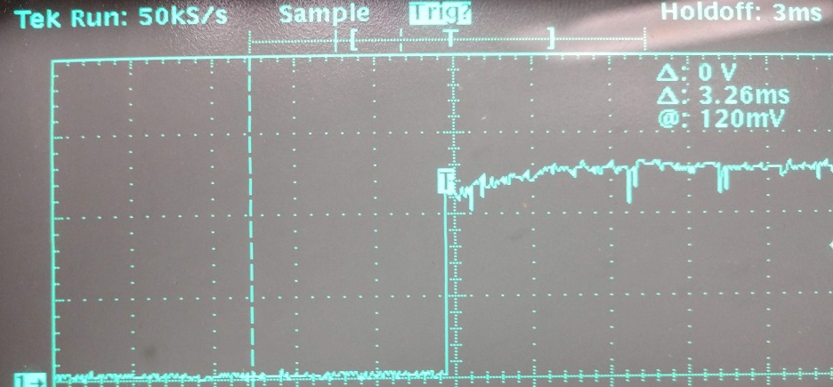

The device keeps ringing when connected to a known input voltage of 5.2V.
The +5 out goes to 3.8 and the -5 goes to -1.8 V.  When the input is momentarily shorted, the output goes to +5 and -5 V
I am using a 2 layer board and the bottom layer is a ground plane  with two small traces. There is a ground plane (RED) on the top layer also.
Please do have a look and advice.
