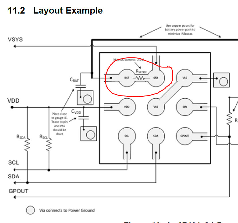

The datasheet says an intergrated sense resistor is present between SRX and BAT pins.
At paragraph 11.2, Layout example, the two pins are showed shorted to each other. It is an error, isn't it? Why should the internal resistor be shorted?
