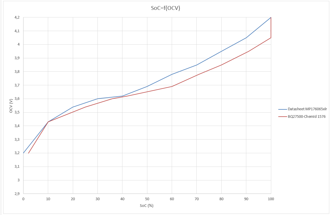

I'm testing a new battery SAFT MP176065xlr with a gauge BQ27500 v1.3.
The device is loaded with a defaut DFI file and with the chemistry MP176065 xlr id 1576. (from ChemicalUpdater-667-windows-installer )
I have also changed some parameters:
- the full charge capacity from 1000mAH to 6800mAH
- the taper current from 100mA to 120mA
I made measures of the initial SOC estimation versus Open Circuit Voltage.
I found that the SOC versus OCV is inaccurate for high OCV (3.4 to 4.2VDC), the SOC error is about 10%.
From 4.2 to 4.04VDC OCV reading, the gauge estimate the SOC to 100% or datasheet indicate that SOC is about 90% at 4.05VDC OCV.
Below 4.04VDC OCV the gauge start to decrease SOC estimation
Is there an other/newer chemical file more accurate for this battery?
If not, what can i do to make this SOC estimation more accurate?
Thank you in advance.
Nicolas.

    I've tried to find a new id with gpcchem but my data returns the following error:
    All IDs disqualified because of too high resistance deviation. No suitable ID selection available
    I think this is due to my cycling discharge rate wich was too high: C/5 whereas the guide indicate a rate of C/10
    I will do a new cycle with this rate and see if it's accepted by gpcchem.

  • Hello Onyx,
    sorry for this late answer.
    As advised, I'have done the chemId identification and the chemistry selected in the report works well.
    The SOC vs OCV curve is fine and I was able to do a successfull learning cicle with it.
    I'm still wondering why the official MP176065xlr chem was problematic, but the most important is to have found a solution.
    Thank you very much,
    Best regards.
