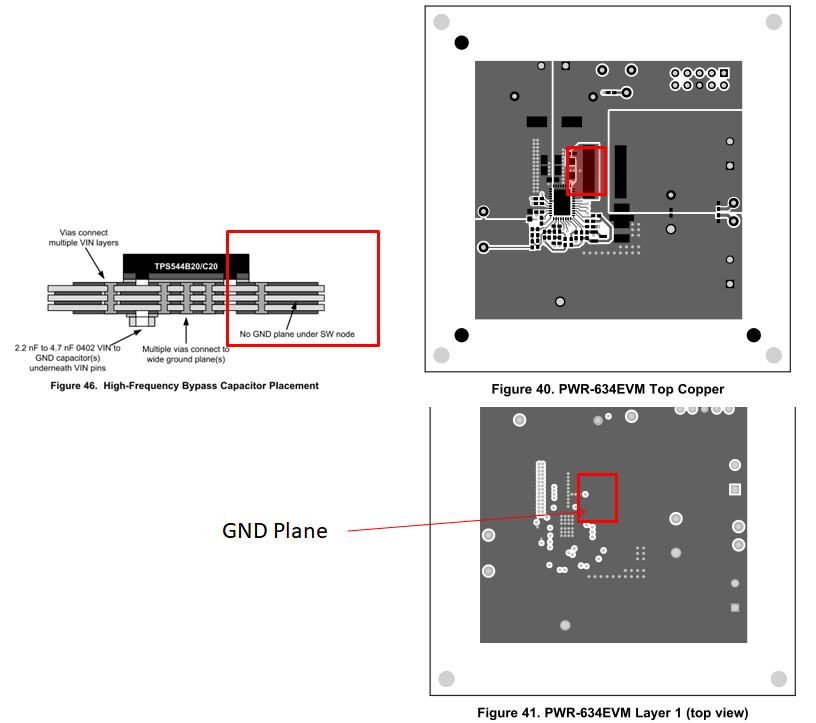

Hi, team.
Although it is described as "No GND plane under SW" in Fig. 46, the GND layer is arranged in EVM, is it necessary?
If necessary, do you need to remove GND of all layers?
Hi, team.
Kobayashi-san,
Yes its perfectly acceptable to have ground plane under switch node. In fact it is not recommended to break up ground planes in any design.
