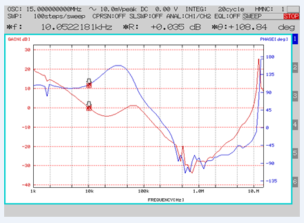

Customer inquired gain margin stability issue for TPS563201.
He measured bode-plot of TPS536201 along application note description as following.
15 db was measured from the data.
How should we consider this gain margin for DCAP2 mode?
There is no description for gain margin in application report SLVA546.
