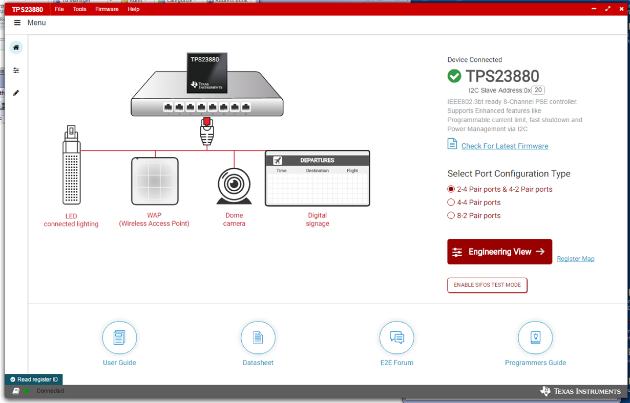

  • Hi Penny,
    Sure, see attached screenshot..
    Yes all jumpers on J4 (for setting I2C address) are installed.
    And the top marking on the TPS23880 chip is: TI 79F SD9Q G4
    Also I don't think the I2C is working between EVM and the USB2anything, because I'm measuring 50V with my meter, and it initially says 50V, but it changed to 30V earlier. Now it's back to 50V after cycling power on/off. But it doesn't seem to execute any commands (like enable/disable ports) when I press buttons on the GUI.
    Thanks for your help,
    -Paul
  • Hi Paul,
    The IC on the EVM is the old silicon revision and the new SRAM code embedded in the GUI doesn't work with the old silicon. We replaced the EVMs with new ICs in June. I suggest you either request TPS23880 samples(It was RTM'd last week) or order a new TPS23880EVM-008 daughter card from TI store. Thanks.
    Penny
