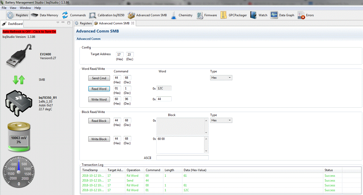

I tried to connect the Bq78350 with Stm32f0 via SmBus. I can read the slave address in Smbus of Bq78350 as 0x16. And I tried to send command like toggle led or reset device (because I wanted to be sure about connection) I couldn't get any reaction from Bq78350. Smbus can find the slave address but when i tried to read data or send command. I couldn't be succesful. I need your help. If i can do a successful BMS with these chips. I will produce so many BMS Card with my microcontroller. Please help me the solve this problem.

  • Hi Sinan,
    I understand. The script generator I sent is a way to convert the data memory contents into a format that you can use to create SMBus commands to write the data flash. However, I can see how this doesn't solve your issue of getting the basic SMBus communication working with the STM32F0.
    Since I am not able to see what is preventing successful SMBus writes from your controller, here are a few suggestions:
    • Make sure you have the proper pull-up resistors on the SMBus lines. The EV2400 has internal pull-up resistors. I assume these are in place on your setup, but just want to double-check.
    • Capture a few SMBus transactions using the EV2400. In bqStudio, there is a Advanced Comm SMB screen where you can run basic commands and you can capture the waveforms to compare with the transactions using the STM32F0. Make sure to disable the Dashboard (as shown in the image below) so that SMBus is not executing constantly to update the values.
    • There is a very useful SMBus app note that explains multiple common issues. You can review this and see if it provides any clues: http://www.ti.com/lit/an/slua475/slua475.pdf
