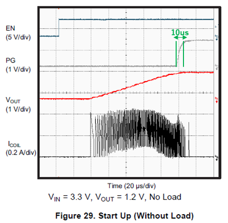

Hi Team,
We would like to know the response time of Power Good.
According to datasheet Figure 29, the response time is around 10us.
Could you please let us know if you have reference value?
*This value does not need to be a guarantee.
