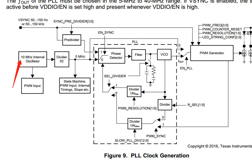

I am now using LP8860A-q1 in display projects and  failed the EMI conduction test in 80M/90M/100MHz~
Can you give me any advice about this?
We use near-field frequency spectrum to test the LP8860, we do find the 10MHz peak frequency and its harmonics, and VDD pin is affacted a lot~
I was wondering why the 10MHz frequency coupled to VDD pin?
And as is described in the datasheet, their is 10MHz internal Oscilator.
I diabled PLL and it does't make any sense.
