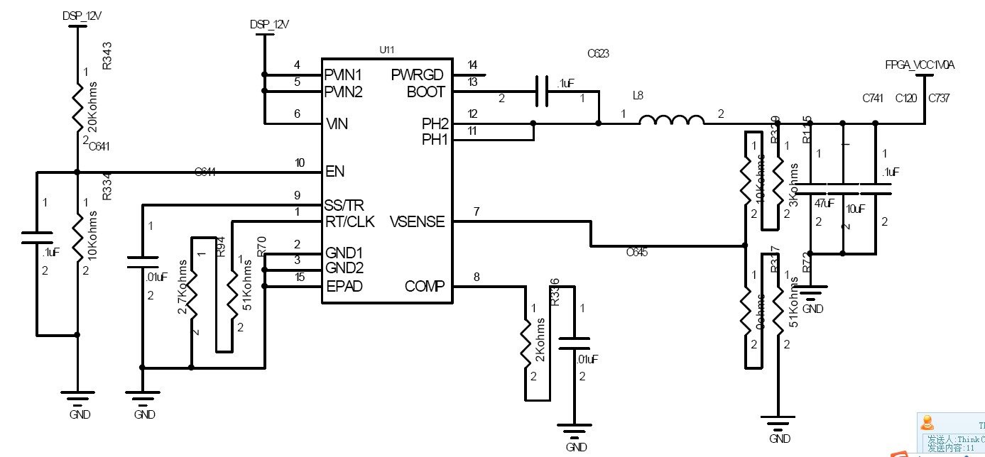

Hi expert,
Please help to review the schematic below:
Noted that there is a 100uf capacitor at the input of FPGA. And all capacitors are ceramic. Thanks a lot!
Yangbo
  • Hi Yangbo,
    I've taken a look at it and have 3 comments below. Do you have any details on how the component values were selected?
    1. Is R94 2.7 kΩ or 27 kΩ? With 12V in to 1 V out, the max fsw I recommend for this is 600 kHz. The RT/CLK resistance should be >~80 kΩ for this.
    2. The TPS54620 requires ceramic bypass capacitors placed as close as possible to the VIN and PVIN pin.
    3. What is the value of the inductance L8?
    Anthony
