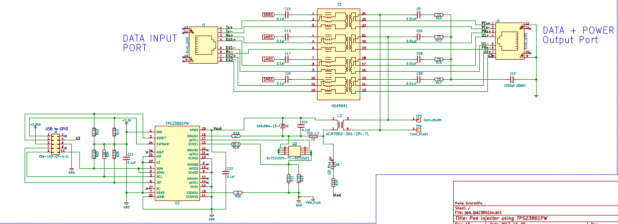

I am trying to implement a Single Port PSE using the TPS23861. I want to operate the TPS23861 in Auto Mode. I am not being able to get the PD Detection waveform at the Drain pin of the IC. Instead of getting the pulses I am getting a constant 46V. The  other voltage readings for the IC are given below:
VPWR- 55V - 53.6V
VDD- 3.6V - 3.12V
The waveforms for DRAIN to GND and VPWR to DRAIN are attached to this post. Also attached is the expected waveform at the DRAIN. /cfs-file/__key/communityserver-discussions-components-files/196/7268.Drain-waveforms.zip
Please let me know how I can debug this problem.
