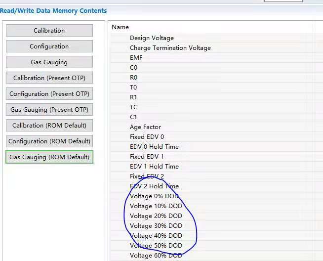

  • hi Onyx ,
    the cedv_profile set hasn't  option to set OCV.
    only has the DOD option.as follow picture.

  • Hi Xing,
    High level, DOD-=100-SOC. So if you have 100% DOD, that is 0% SOC. If you have 100% SOC , that is 0% DOD. So input your data accordingly.
    I looked at your attachement, and you did not follow the instructions in the gpccedv user manual. You ought to have four columns which should be in this order, elapsed time, voltage, temperature, and current and the headings of the columns should be labeled. You have 5 colums. Pls carefully follow the instructions of gpc cedv and you will get correct results.
    thanks
