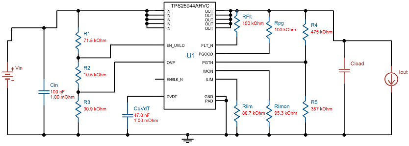

I was checking WEBENCH output with datasheet equations about RIMON.
Page 25: Maximum RIMON is determined by Equation 6.
My design inputs are:
VIN=3.3V
ILIM=1A
with GAIN=52uA/A the R(IMONmax)=13.221K Ohms
But when I use these inputs on WEBENCH, I got: RIMON= 95.3K Ohms which is way higher than the maximum value mentioned in the datasheet by Equation 6.
I have noticed a field on webench desig Advanced Option n inputs: IMON Max Voltage, which is set to 5V by default:
Is this something outside datasheet?
I am getting confused about setting the RIMON on this device.
