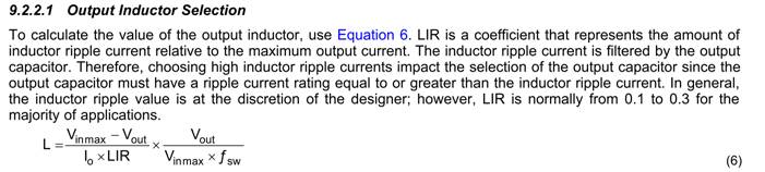

TPS65262: TPS65262 - Inductor selection and Iout
Part Number: TPS65262
Hello Team,
In the formula used in section 9.2.2.1 are written Io, Iout, can you confirm that both are the same and stand for RMS current?
