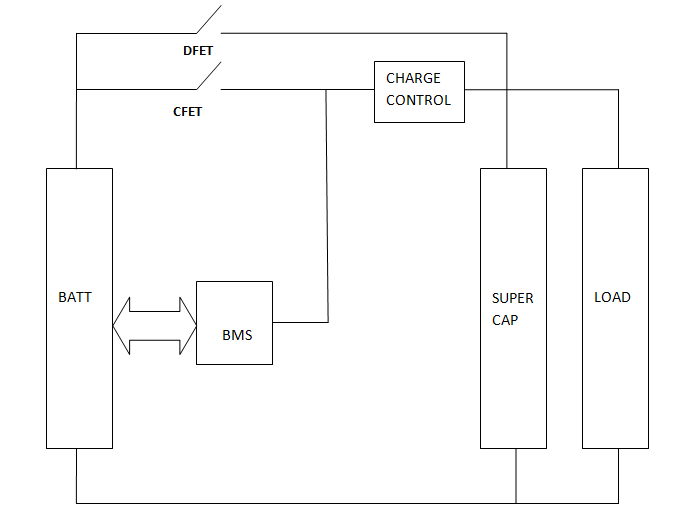

  • Hi Roger
    I am the customer who Mandar refers to.
    Thank you for your reply.Much appreciated.
    Please find a rough block sch for the system under discussion attached to this post.
    As you can see above , I am looking for a similar solution.
    I have asked earlier
    1) does PL455A have any default values? or it awaits instructions from the host MCU?
    2) I have shown how the protections should be present above. Is there any other allied solution present which does this?
    3)Single path means having the CFET (Charging FET ) and the DFET (Discharging FET ) in series and dual path is self explanatory.
    Can you please guide me so that we can move ahead?
  • Let me respond one at a time.
    1. PL455A is slave mode. Host has to instruct PL455A. And, PL455A doesn't have ways to control the FETs.
    2. If it is industrial application then we have integrated solution. PL455A is just monitor and feed voltage info to Host and host controls the FET.
    3. CBET and DFET will be control by uC or other ICs. PL455A will only monitor Batteries. It has no current sensing capability as well. It means you must have INA, hall or something to measure the current and feed info to host and host to control the FETs.
    PL455A is slave IC. It has no intelligent.
