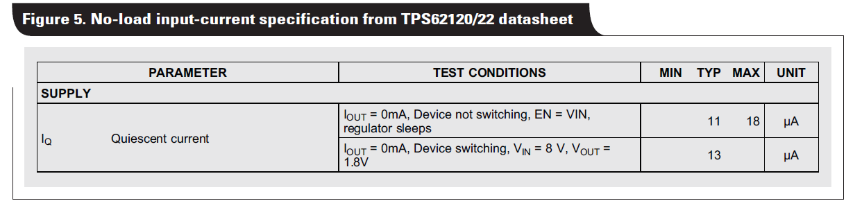

    The TPS62090-Q1 datasheet only shows quiescent current at non-switching, can we have the quiescent current at Vout=1.8V?
    Or can i use quiescent current at non-switching to replace the quiescent current at Vout=1.8V? i think they should be really similar.
  • Did you read the application note I mentioned above? I think it describes the analysis you plan to do in very detail. So I would expect that you find all answers to your questions there.
    Non switching is not related to the output voltage. It basically defines that there is no output current which means that there is no need to transfer power from the input to the output.
  • i did read the application note. and i totally understand the iq is not input current and it's defined at non switching condition.
    but the application note shows a datasheet which has quiescent current data at both non-switching/switching. so that's why i ask the iq again to see if we have iq  at switching condition or not.
  • The second spec line for the quiescent current in the example shown above is including the current through the feedback divider on the output. From a device point of view this is a very low output current and requires switching at a very low frequency. You would find that information in the application note as well.
