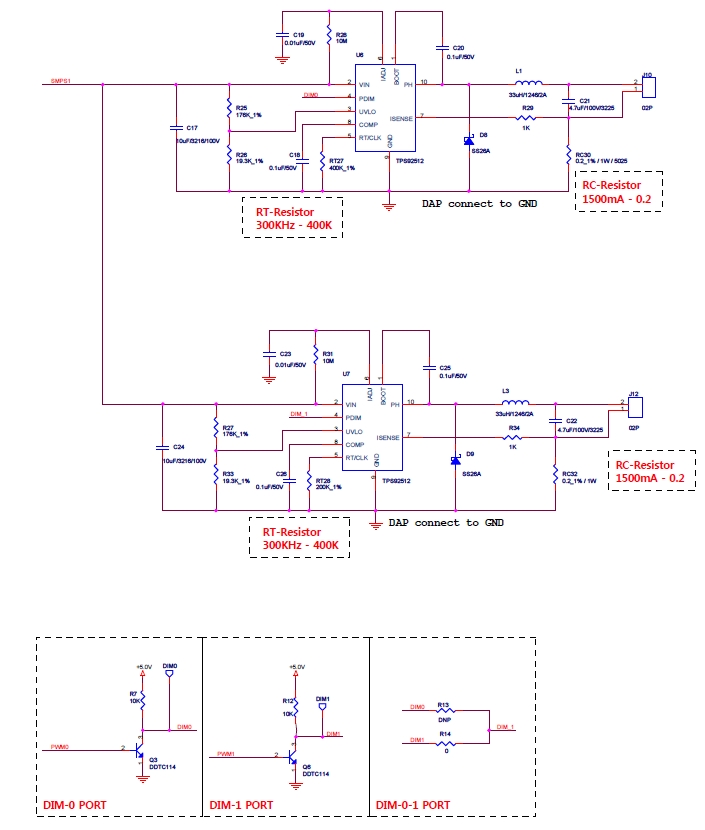

Upon attached schematic, audible noise generated from Inductor(L1 and L3) when dimming.
- Using PWM frequency 16.kHz : Barely hearable(Very high frequency noise)
- Using PWM frequency under 16kHz : Hearable. getting louder when decrease PWM frequency.
TPS92512 reference kit is bit better than our board but I also can hear noise from it.
Any recommends to get rids of this noise would be very appreaciated.
Thanks.
Hello Jay,
1) You can try the distributed airgap inductors. Also you can RTV the coil or varnish. It is a difficult problem due to the high di/dt in the audible noise band. You can also increase the PWM frequency but you will lose dimming accuracy. Another thing to try is partially analog dimming first to get the current amplitude lower then using PWM dimming for deeper dimming.
2) You could try a higher value but I think you will find it will still cause noise. This is a common issue so you may want to search the internet for solutions. You may even find better parts this way. I know this to be true for ceramic capacitors which can also emit noise.
3) You can use other materials, you just want to make sure it is intended for the application you are using.
