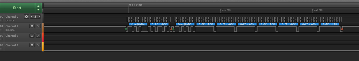

we have got one evm board, we were not able to communicate with it using USBANY EXPLORER although we followed the user manual.
I have started developing the FW to communicate with I2C. I am getting acknowledge when writing and reading but the info returning when trying to read ADh command( DEVICE ID) I am getting 0xff for each byte instead of the device model characters.
I have connected scl, sda lines to J13 pin 19,20 ( same order ) and also gnd to pin 27.
Do I need to do other procedures on the board for it to work ?
Am I doing something wrong or is it a malfunctioning board ?
attaching logic analyzer capture:
more findings:
I have also tried to first write to write protect register 0x10 the value zero. ( to enable write to other registers ) not sure if its mandatory for reading but the same issue occurs getting acknowledge with values of 0xff.
