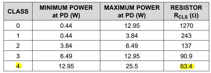

Hi Sir
My customer design as attached file.
the customer question that If there want to change from class 3 to class4, we just need change Rls from 63.4Ω to 90.9Ω. am i right?
or we need change other component?

Chen,
Here is a 12V/2.125A reference design featuring TPS23751 that is certified by the Ethernet Alliance to be fully compatible with the PoE standard. It is fully tested & optimized for your power level. Feel free to copy:
www.ti.com/.../PMP11254
