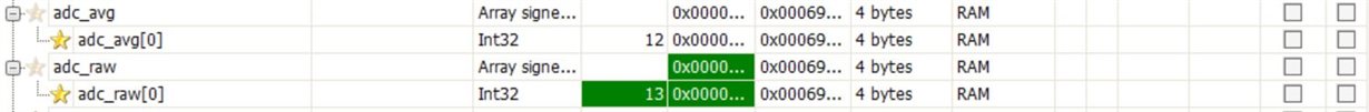

  • Hi Mr Bolurian,
    I use the internal temperature sensor directly,but the raw value is only 12!!It's so small.Could you tell me what's wrong with it?(The Code is simple:I initiate adc,and use poll_adc()).I did not  do any conversion.

  • I could reproduce the issue that you are reporting on my setup as well.
    The temperature signal seems to be connected to channel 14!
    This is strange; I have started to investigate this and double check why this happens.
    Meanwhile, please check the configuration when:
    AdcRegs.ADCSEQSEL0.bit.SEQ0 = 14; //temperature
    instead, and see if you can read the temperature.
  • Hi Larry,
    I have double checked this and indeed the temperature sensor is connected to channel 14.
    We will change the documentation accordingly.
