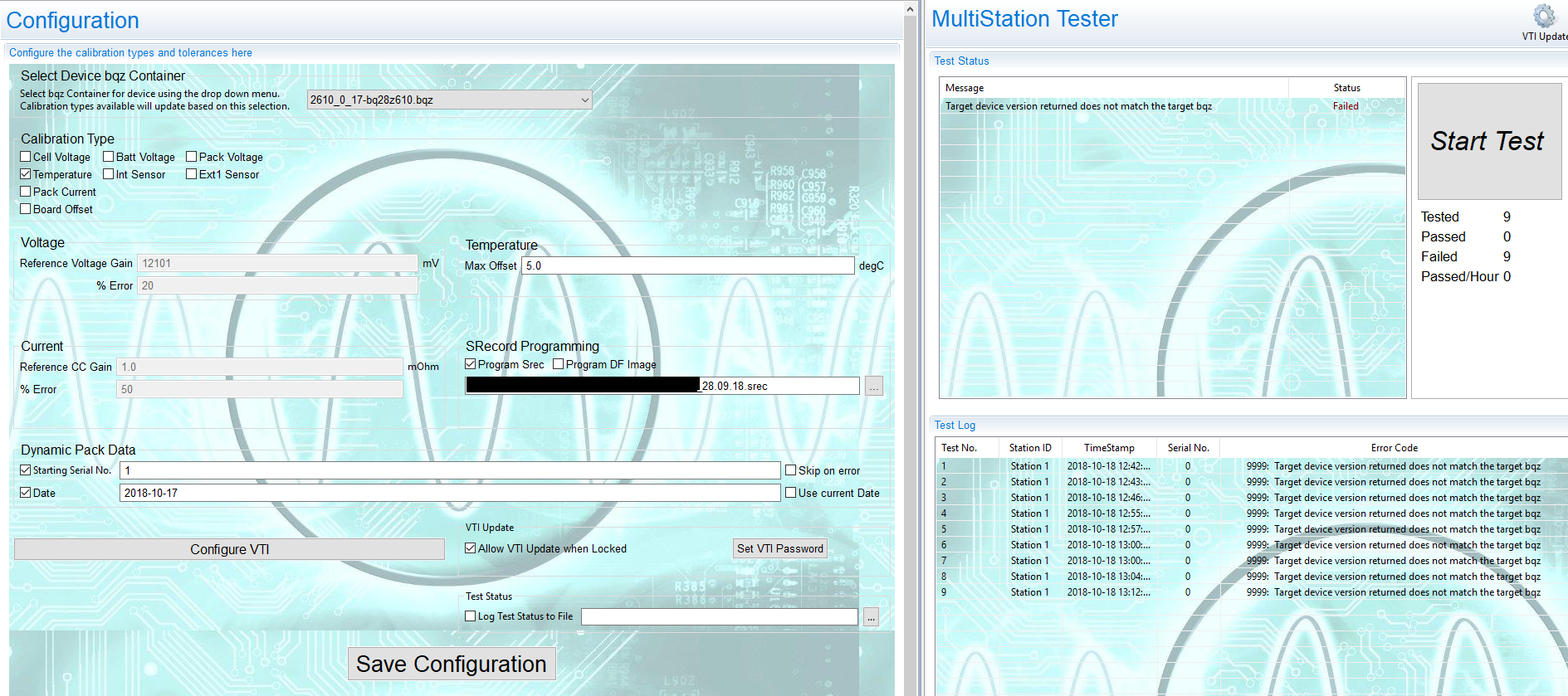

our Company purchased a HPA495_Rev. A Advanced BQmTester Board. It works fine in bqproduction with the BQ4050, but we also planned to use it with Bq28z610 (2610_0_17) and with Bq40z50-R2.
The software returns Error Code 9999: Target device returned does not match the target bqz.
For Bq28z610 (2610_0_17) , and for bq40z50-R2 we took the bqz file stored in the BQStudio files. Is there any source for correct bqz files?
