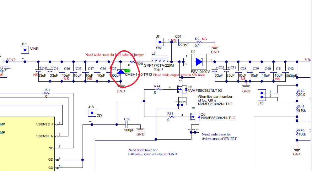

LP8863-Q1: What's the purpose of D3 in SNVU558--EVM user's guide?
Other Parts Discussed in Thread: LP8863-Q1
 Number: LP8863-Q1
Hi Team,
     I don't know exactly the purpose of D3. Would you help to explain?
    If the power line FET is turned off for some fault protection, the energy in the inductor has the potential to cause negative voltage on the input, which may damage the electrolytic capacitors. The schottky diode is used to avoid negative voltage on the input capacitors.
