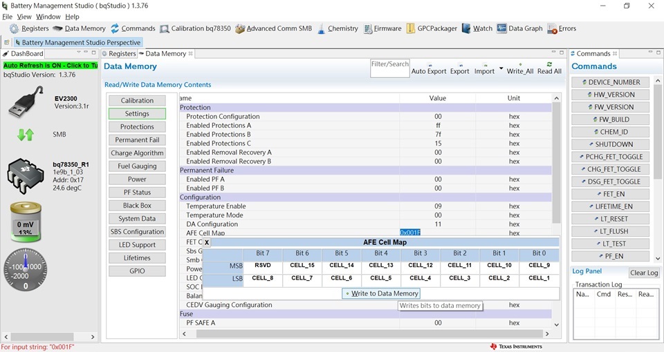

  • Hi David,
    Thank you for your suggestion, i used to use BQ76920+BQ7350-R1 for 5S1P 18650 application.
     According to your BQ76920+BQ78350-R1 suggestion, and i check BQ76920 datasheet that BQ76920 support to 5-series cells.
    If i use BQ76920 for 5S2P application, the placement will be as blow
    Do it work for BQ76920 monitor and cell balance function?
    By the way, how about the cell map set up in BQ78350-R1 GUI?
    Is it the same as 5S1P set up?

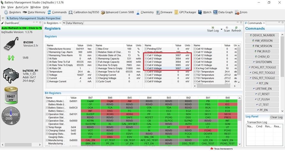

    Finally, Will the cell voltage monitor result be the same as 5S1P result?
    The GUI will only display voltage of 5 cells, is it correct?
    thanks.
  • Hi Chiayuan,
    The setup will be the same for a 5S2P configuration. Each pair of cells in series is treated as one block, so it will look the same to the monitor and gauge. When you set up the gauge, be sure to update the design capacity since this configuration will double the capacity, but all voltages will stay the same and cell balancing will still work.
