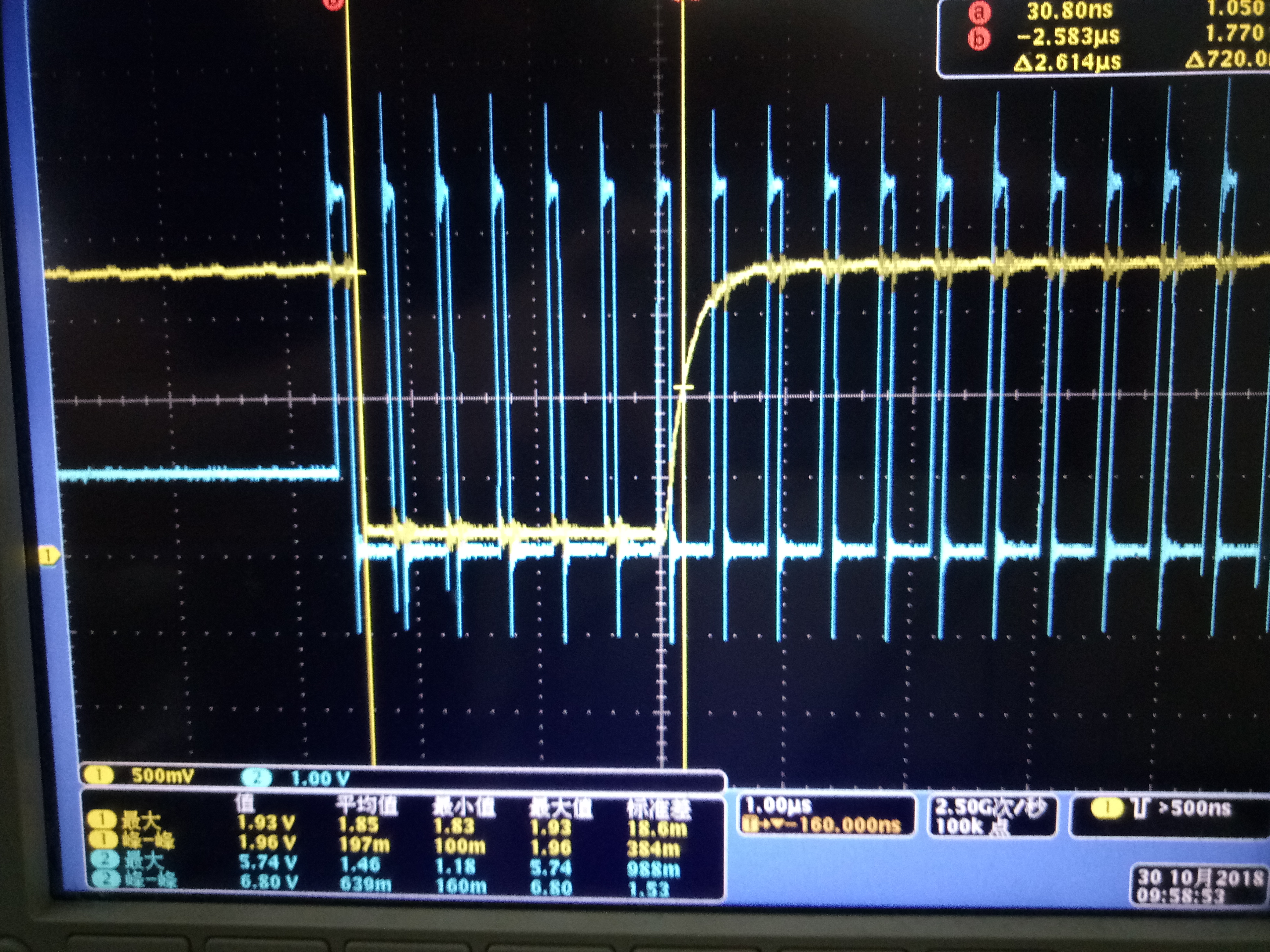

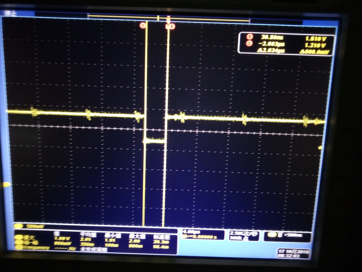

       The scope shots as below. The channel 1(Yellow) is POWERGOOD signal, the channel 2 is VRTC.
    It would be still very helpful to understand what is happening to the load during the time that POWERGOOD goes low.
    Can you take a scope shot of the current during the time that POWERGOOD goes low (include SMPS1_SW, SMPS2_SW, POWERGOOD, load current)?
    If you can't include the load current, can you include the SW pins? It would be very helpful to understand if there is a load transient behavior happening at the time of this event. Ideally, looking at the load current would give use the most information.

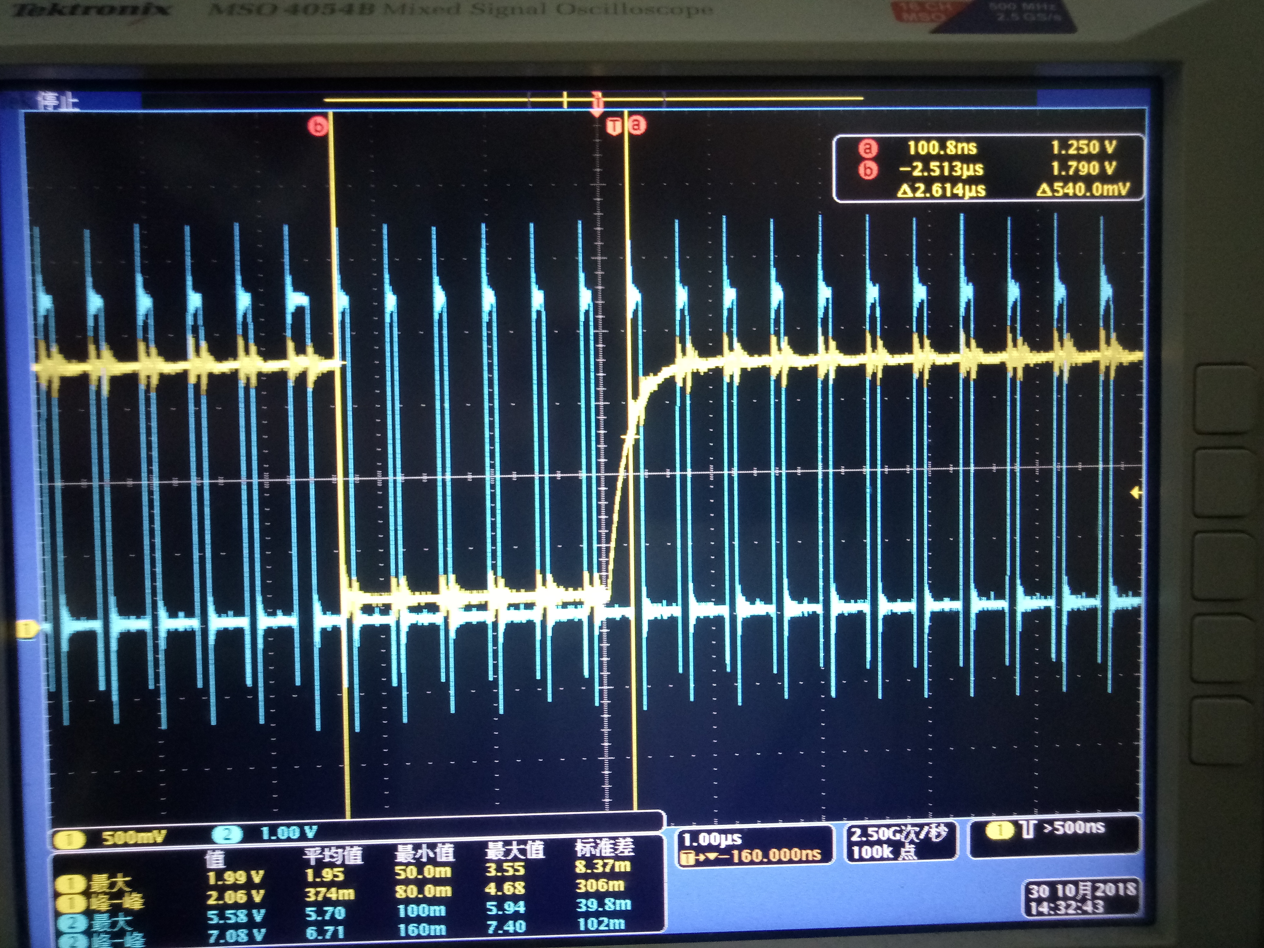

       The scope shots as below. The channel 1(Yellow) is POWERGOOD signal, the channel 2 is SMPS1/2(VDD_MPU).  We are measuring the SW pin now.
     The channel 1(Yellow) is POWERGOOD signal, the channel 2(Blue) is SW PIN
    SMPS1_SW
    SMPS2_SW
    Thanks for these scope shots. I am working on reproducing this behavior in our lab. I will try to provide an update by the end of this week.

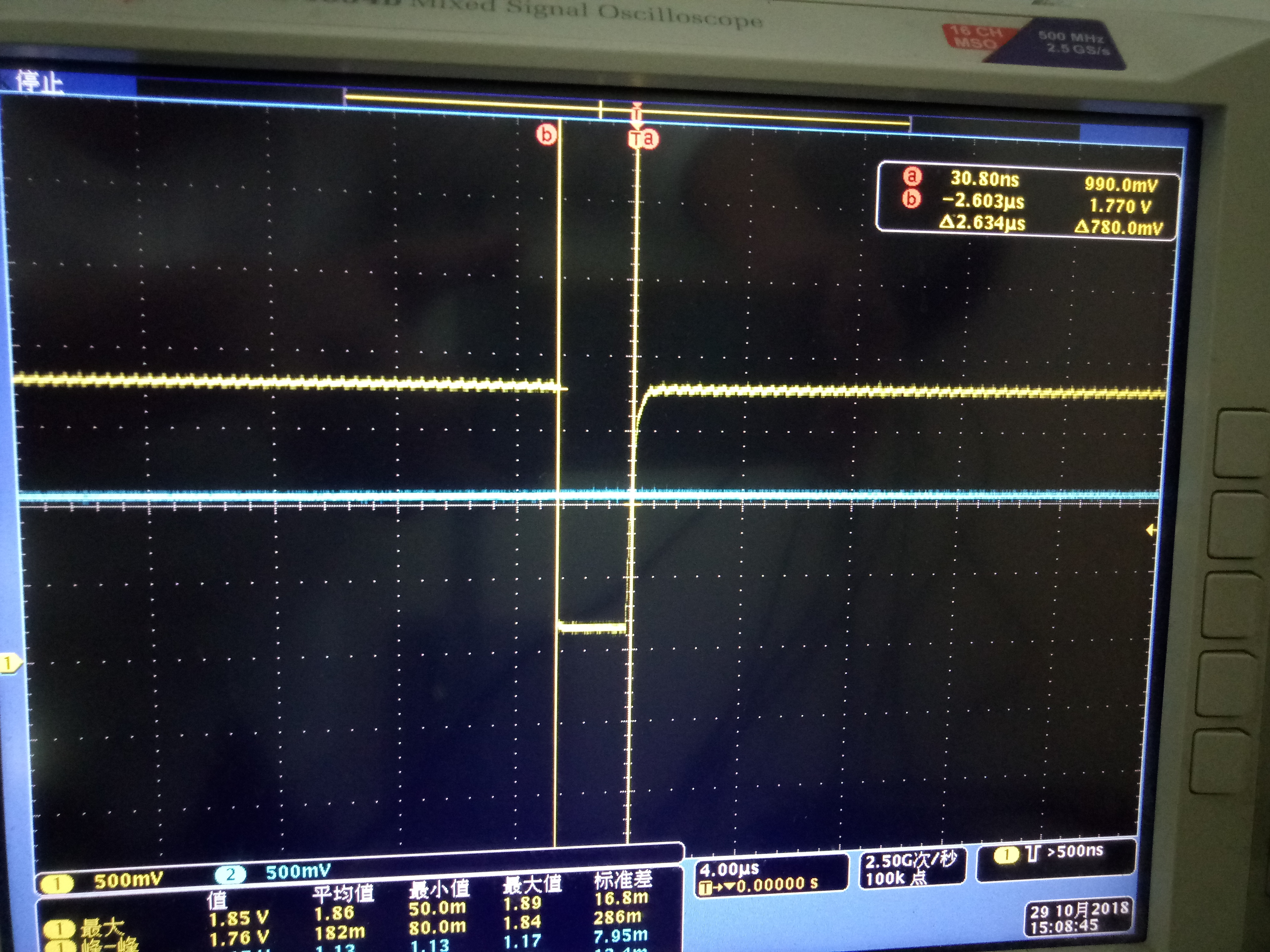

     We tested the "POWER GOOD" signal on the IDK board(The "POWER GOOD" signal had no connect on IDK board, In order to keep the same as our board, we add a 10K pull high resistor to VRTC_OUT), also the  "POWER GOOD" signal would be pulled low to 1.25V(the low pulse width about 2.6us) when testing in -40° temperature on IDK board. Here is the  scope shots.
    I understand that you see this behavior on the IDK board. However, you would still need to measure the current to understand if the SMPS12 rail is reaching current limit. The current is dependent on the activity the processor is doing and the software running on the board.
