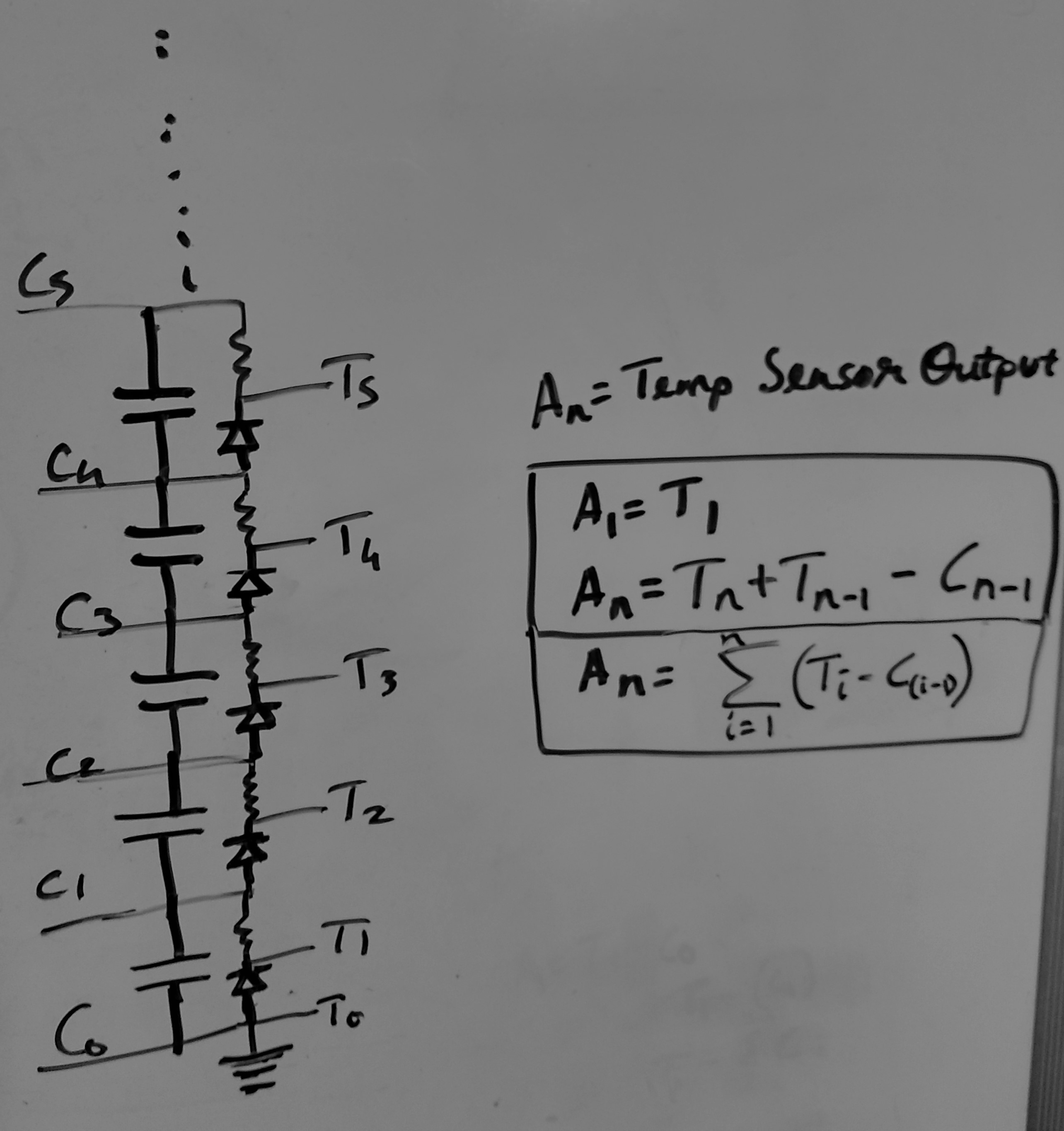

Since my application requires all 16 cell temperatures, I want to use the second device to measure cell temperature. The image below briefly explains how I plan to achieve this.
The temperature sensor is a temperature controlled voltage shunt(a zener diode with zener voltage proportional to the temperature) shown in the drawing as a simple diode due to lack of creativity. Cn is the voltage sense inputs to device1, the primary cell voltage measurement device. Tn is the inputs to device2 which is used to measure the temperature sensors' voltages. An is the actual voltage across the temperature sensor(the one with a diode for a symbol).
This configuration allows me to measure all temperature sensors with minimal additional cost, and fewer components on the board. The precision of the temperature measurements is up to 16x worse, but for my temperature sensors, that corresponds to <1C, which is sufficient for me.
However, this raises some issues, should I provide separate power supplies to each chip? I will be removing VIO to cause the chips to enter SHUTDOWN mode. And use a WAKEUP command over differential comms to turn them back on. VIO is supplied from VP, but a relay in series is used to connect/disconnect it, allowing externally hardware controlled shutdown of the devices as required by my application. Having one of the devices (for example, device1) controlling the NPN power supply, might unexpectedly remove VP and VDIG power to device2 if device1 enters SHUTDOWN sooner after VP power is lost. Is this acceptable?
This question is more of a clarification. If I use a single NPN power supply, the NPN controller (device1 using the case assumed above), would have to be the lower device in the communication stack right? This would allow it to receive the WAKEUP command first, and generate VP before device2 above it turns on. Will this work at all? Would the VP rise time be longer than the propagation delay through device1 to device2 and the subsequent powerup of device2 that isn't configured to control the NPN supply? Maybe this is answered in the datasheet, but I was unable to find it.
Are there any other issues that I might have missed when using these devices in this manner? Especially since this is far from the use case described in the datasheet.

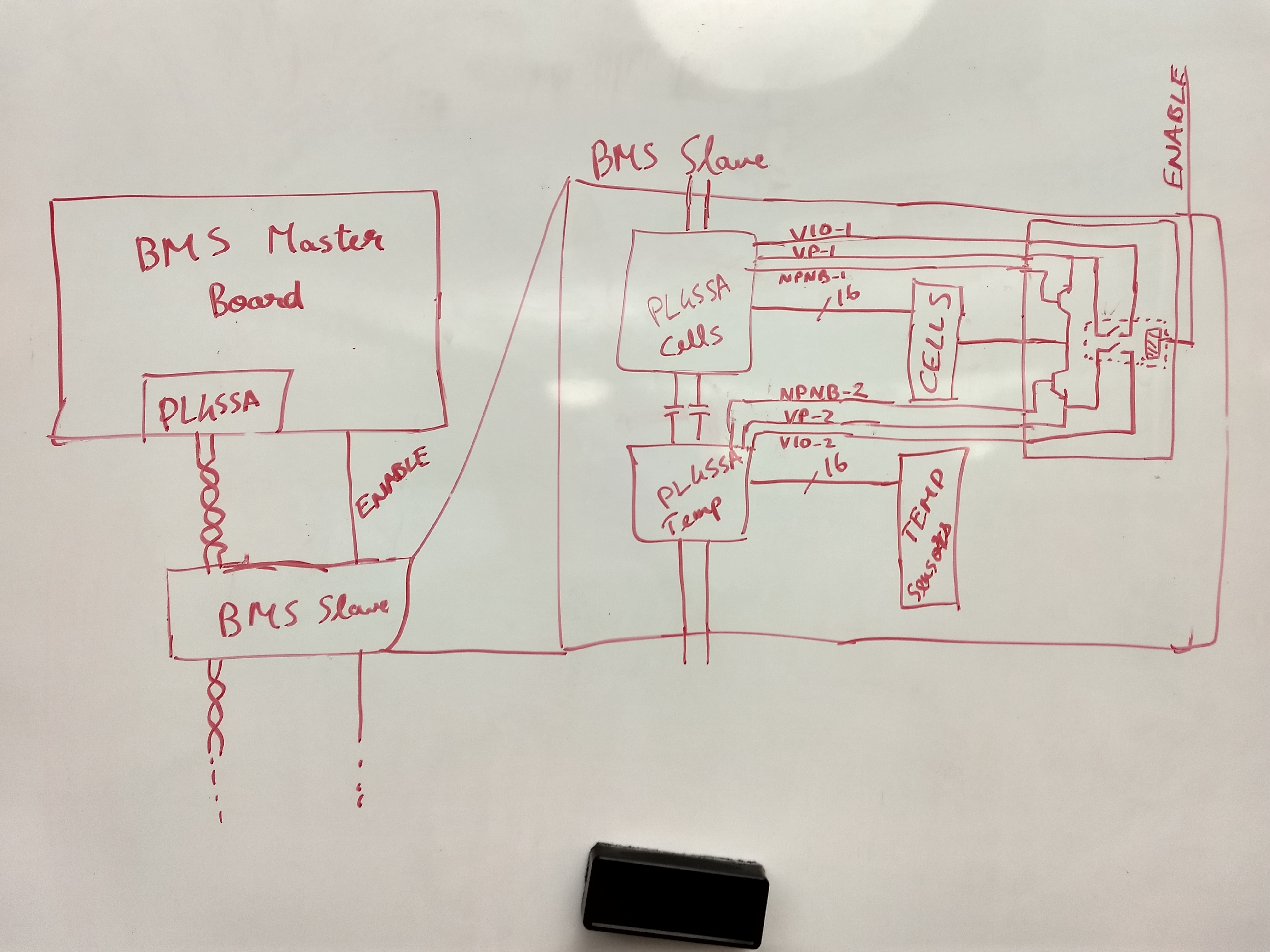

    Below is a more detailed diagram/schematic of the system I am planning
    "Protection" - just the back-to-back signal diodes and resistor described in the datasheet along with ESD protection
    "AFE" - Balance circuitry and input filters for the cells
    "VSn" - VSENSEn inputs to the pl455(device1), EQn outputs go to the AFE to control discharge, however, it hasn't been shown
    "Tn" - VSENSEn inputs to the pl455(device2) for temperature measurement using the method in the original post, EQn outputs for device2 are not used
    The simplified circuit at the top is the power delivery circuit controlled by a single device that I am proposing.
    I will attempt to create a flowchart block diagram describing the SHUTDOWN/WAKEUP procedure and post it as soon as I can, but I shall describe it in words here. The switch labeled "relay" is the externally controlled relay that will be used to cause the boards to enter SHUTDOWN when opened. To resume, the relay is first closed, returning VIO power, and then the WAKEUP command is sent over the differential communication line to turn on each device.
    I realized I had another question, what if anything would happen if I connected the base of the NPN transistor to NPNB on both device1 and device2 using 2 diodes to prevent reverse current? This would allow either or both devices to drive the transistor and supply both circuits. This is all in an attempt to save board area, however, if this isn't feasible, I assume separate power supplies would be the feasible and fool-proof solution?

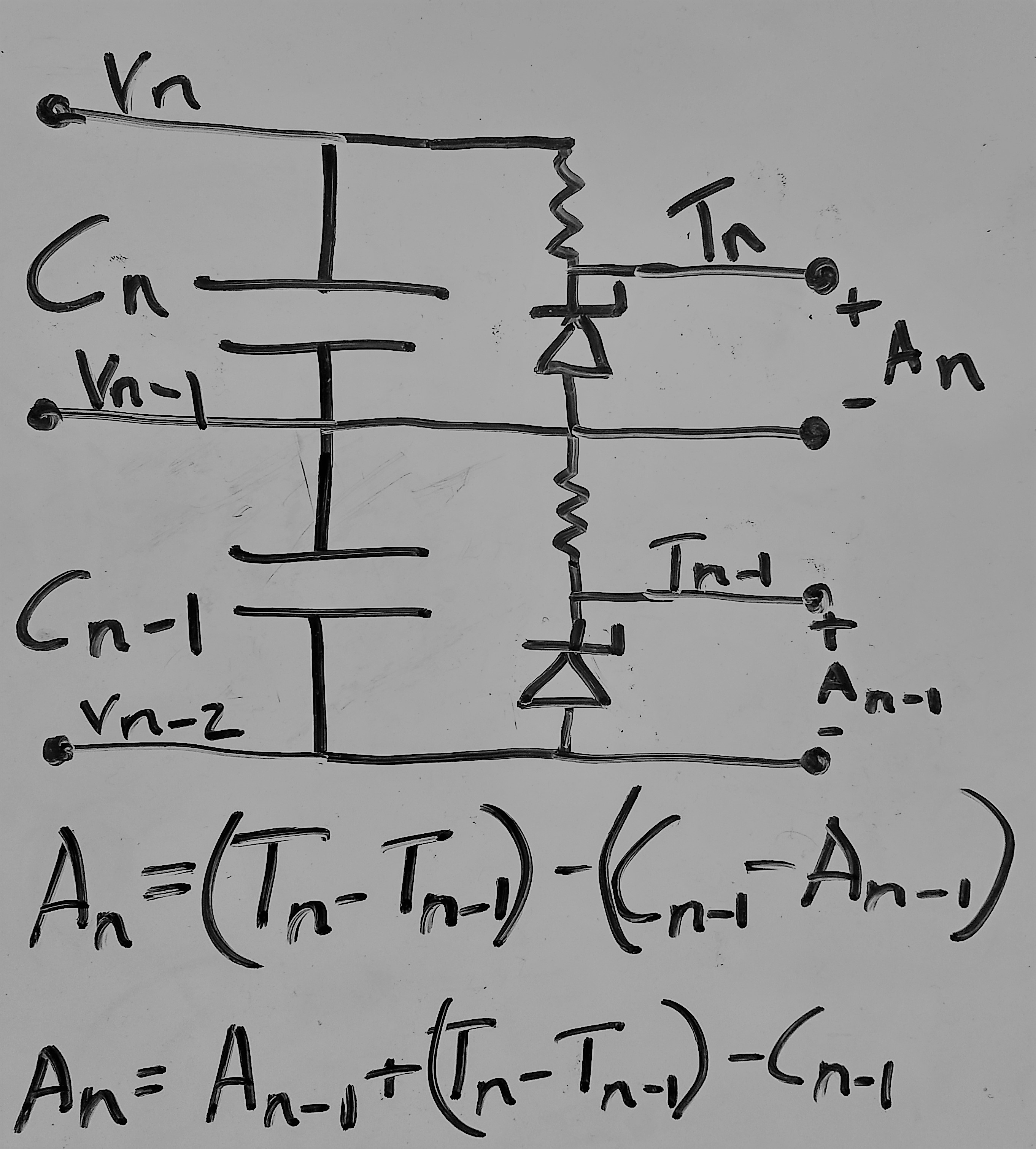

  • Below is the circuit and the formula I would use to calculate the voltage across each sensor. As mentioned in the original post, the temperature sensors are actually a proprietary technology which behaves like a zener diode with zener voltage varying with temperature, PFA  a datasheet that has all additional details.
    A_n is the temperature I'd like the measure, ie, the differential voltage across the sensor(I used a zener diode symbol because I'm not sure what the standard symbol for such a sensor would be)
    V_n, V_n-1 and V_n-2 are the voltage sense inputs to IC1
    T_n and T_n-1 are the voltage sense inputs to IC2
    I did originally have a mux, but I'd also need to have high-voltage difference amplifiers(INA148) to remove the common mode voltage so that the 0-5V AUX inputs can measure them. Additional mux(es) would also be required to enable reading all 16 cells if I only had a single pl455. 16 INA148s is prohibitively expensive and an additional pl455 would be much cheaper and reduce BOM count which also lowers assembly time and costs.

  • I am extremely sorry for the confusion with the incomplete block diagrams. On each board, the devices will share the same GND but their communication will be through the same daisy chain. There will be 6 such boards with 16 cells each. There will be an additional communications bridge at the bottom of the daisy chain.
    The question was whether I could place a relay between 'TOP' and the collector of the NPN BJT. This would allow me to use an external signal to turn the board on and off, one of the requirements of my application. I would not be using external power, just disconnecting the NPN from the cells, and I was wondering if that was an acceptable practice, and whether there was any defined behavior expected when the NPN is reconnected. The suggestion of using an external linear regulator was to force a consistent startup behavior by ensuring all power supplies were operational before the chip receives a WAKEUP pulse over the daisy chain. However, I will take your suggestion and use 2 separate NPN supplies, I think I have found some dual NPN packages that are sufficiently compact.
    Hence, the only question that remains is the one about placing a relay that disconnects VIO from VP to cause the chip to enter SHUTDOWN. To exit SHUTDOWN, the relay will first be closed, connecting VIO to VP via a 1ohm resistor, and then the WAKE pulse will be sent over daisy chain. Does this seem viable?
    I apologize again for all the incomplete information
    Chaitanya
  • You don't need any relays. NPNB will shut off and ON the NPN transistor in Shutdown and wakeup mode.
    When you send wake signal to base device, it will wake base and daisy-chain device as well. Same as shutdown.
    Just follow our recommendation then PL455A will take care your wake and shutdown.

  • I'm not entirely sure what a block diagram is in the way that you would prefer. Below is a diagram that covers the entire system's power supply functionalities. The idea is to use the BMS master board's enable output signal to turn on and off the entire stack of slave boards
