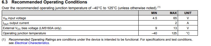

I have fly-buck topology application.
Vin=4.5-65V, Vo=12V, Io=2A
I find LM5160's datasheet Io=1.5A, but website is 2A, which one is correct?
Is there any suggest IC in fly-buck application?
thanks,

When I open the datasheet, I see the output current is rated to 2A.
For example flybuck designs, there are multiple reference designs on the Tools Tab, including: www.ti.com/.../PMP15005. You can also see the EVM with the flybuck configuaration: www.ti.com/.../lm5160dntfbkevm
