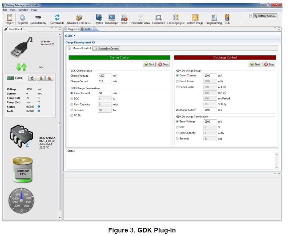

  • How do you use the GUI to get CHEM ID? I thought the only way would be writing a simple script (charge, relax, discharge, relax)
  • when you connect the gdk and start bqstudio, click the gdk tab. The manual conntrol as seen below will allow you set charge, discharge and relaxation and the no of cycles which is all you need for both chem id identification and learning cycle.
    See the quick start guide of the gdk for additional details.
    thanks
    Onyx
  • Ah, ok. But that's not automatic and that's why I prefer the script. We do not have people 24 hours able to change modes in time. I will have to try then what temperature is used when the script generates the log file. Can you log also using the manual control?
  • sorry, there is a thirdtab that was not captured in the snippet that is for automatic control.
    There are three tabs, manual, automatic and scriptable control
