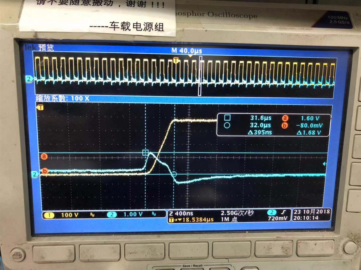

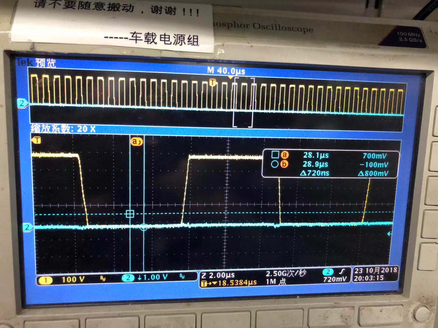

    Please refer to the detail scenario as below:
    the customer use the UCC21521 to drive the LLC stage second side full bridge,
    When they try to make the full bridge works like a passive rectifier, they set EN=low. The issue is that there is a small pulse output on the Vgs of the high side SiC FET.
    Please refer to the picture. The low side is OK. The Vgs would be locked at 0V. but the high side Vgs, there is a small pulse.so the customer doubt the sink current ability.
    Could help to analysis on this? Thanks.
    the low side Vgs the high side Vgs
    Regadrs
    Robin Liu
  • Hello Robin,
    Thank you for the scope captures.
    Is channel 1 Vds?
    What is the SiC FET part number that your customer is using?
    Lastly, can you post the schematic? This will help me look for issues.
    Mateo
