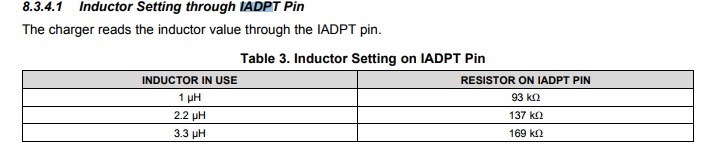

Dear Specialists,
My customer is considering BQ25703A and has a question.
I would be grateful if you could advise.
I am considering a resistor at IADPT pin.
I'd like to use 1.5uH inductor, what ohm should be used?
According to the datasheet P.25, Table 3., it only described 1uH, 2.2uH and 3.3uH.
I appreciate your great help in advance.
Shinichi

    In general, we didn't recommend to use 1.5uH inductor. Is it possible to stay with 2.2uH?

  • Hi Shinichi,
    The pin is sampled at startup and the inductor value specified is used to reconstruct inductor current (it is sensed at the switch, so only rising inductor current can be directly measured.).  The inductor value used for reconstruction is not linearly related to the resistor value, instead the resistor value is latched into one of the three bins specified in the datasheet, i.e. 1.0, 2.2, 3.3 uH.  If you use a different inductor value than one of these three, it will incorrectly reconstruct the inductor current and this will adversely affect the feedback circuit.

    I understand inductor should be selected from 1uH, 2.2uH or 3.3uH, not used other inductor.
    Could you please advise, 1.5 μH is stated in the data sheet P.36 as the inductance value at the switching frequency of 1.2 MHz.
    Is it possible to think of this description as a mistake in description?

    I spoke to our systems engineer about this reference of 1.5 uH on P.36 and he informs me that this reference to 1.5 uH will be removed from the datasheet in the next revision.
