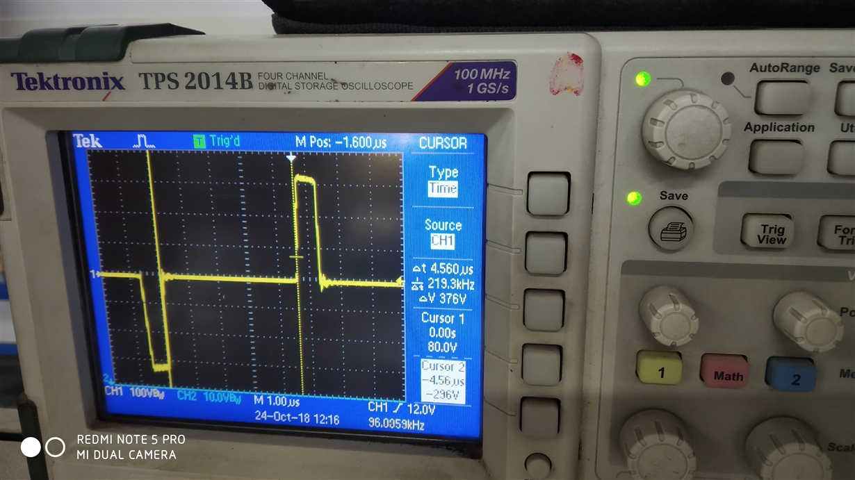

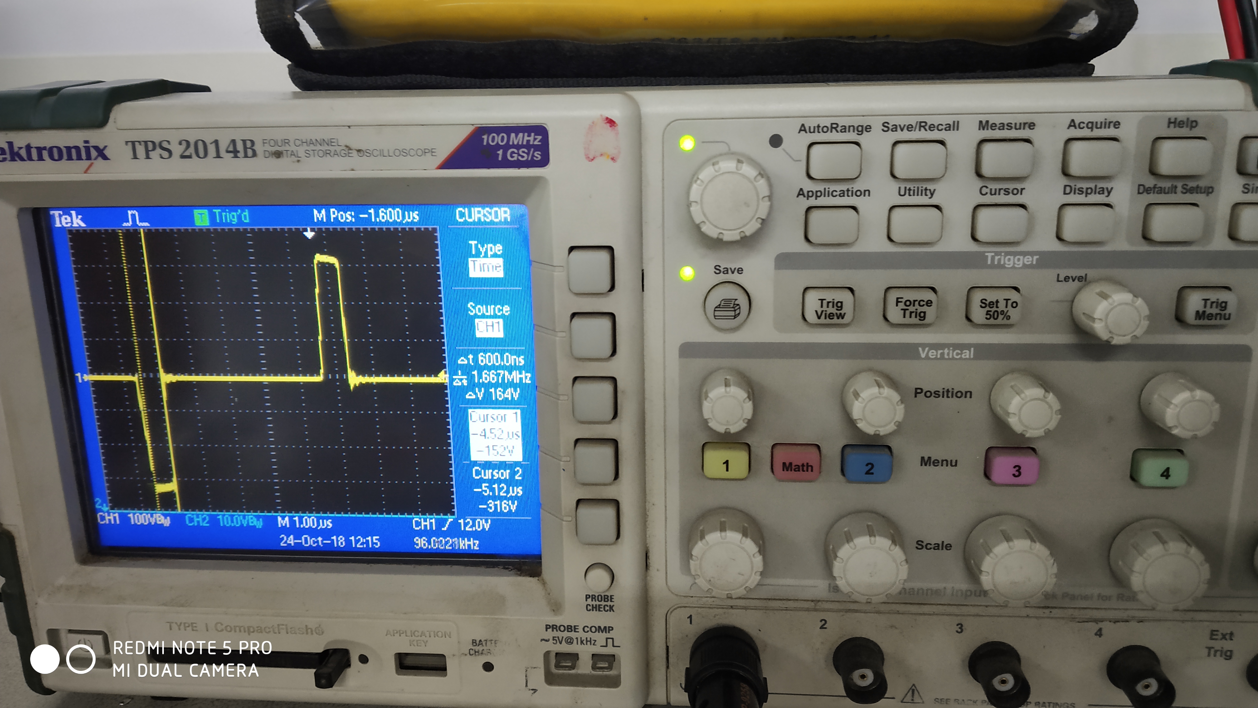

  • Dear Roberto,

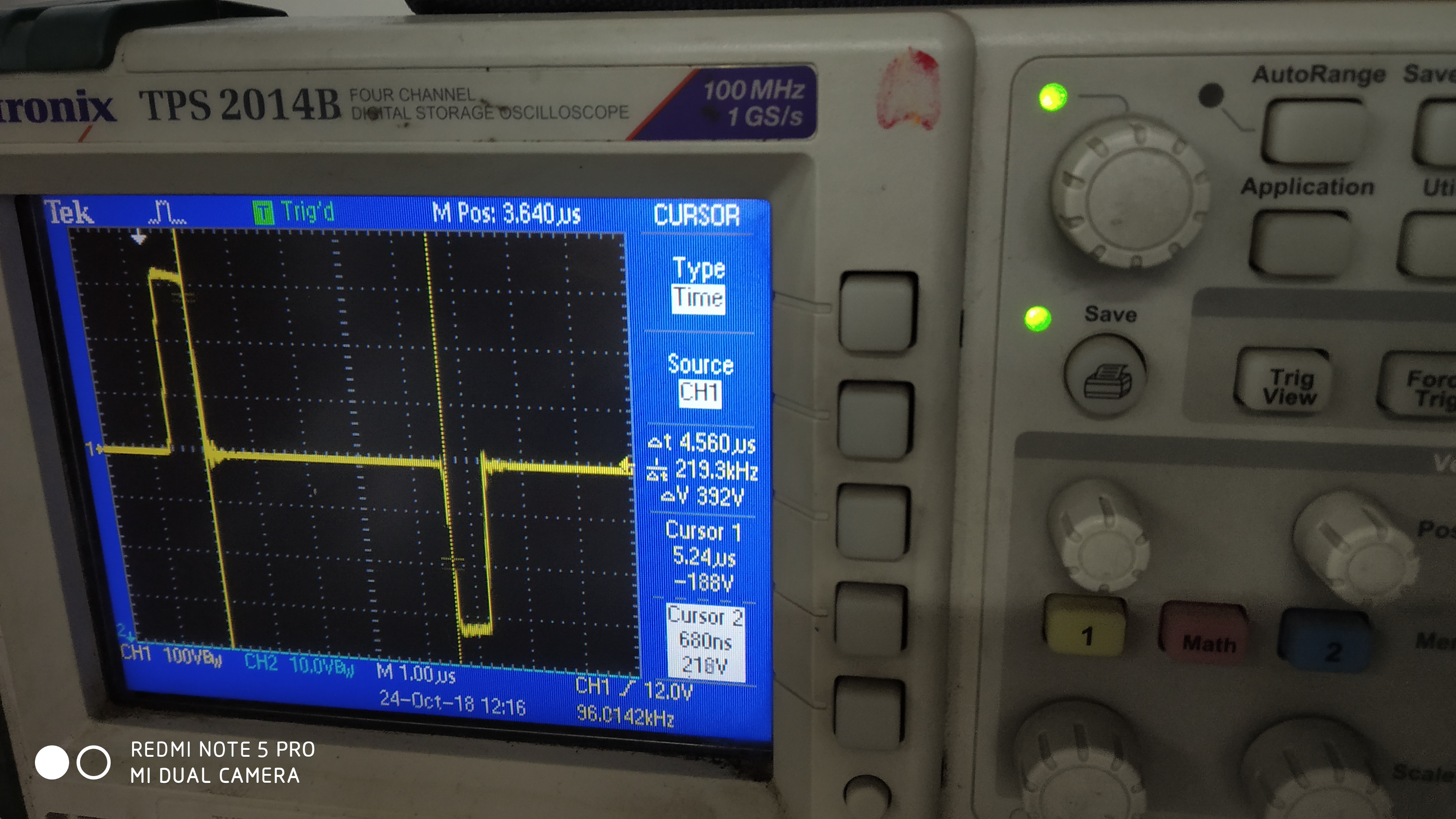

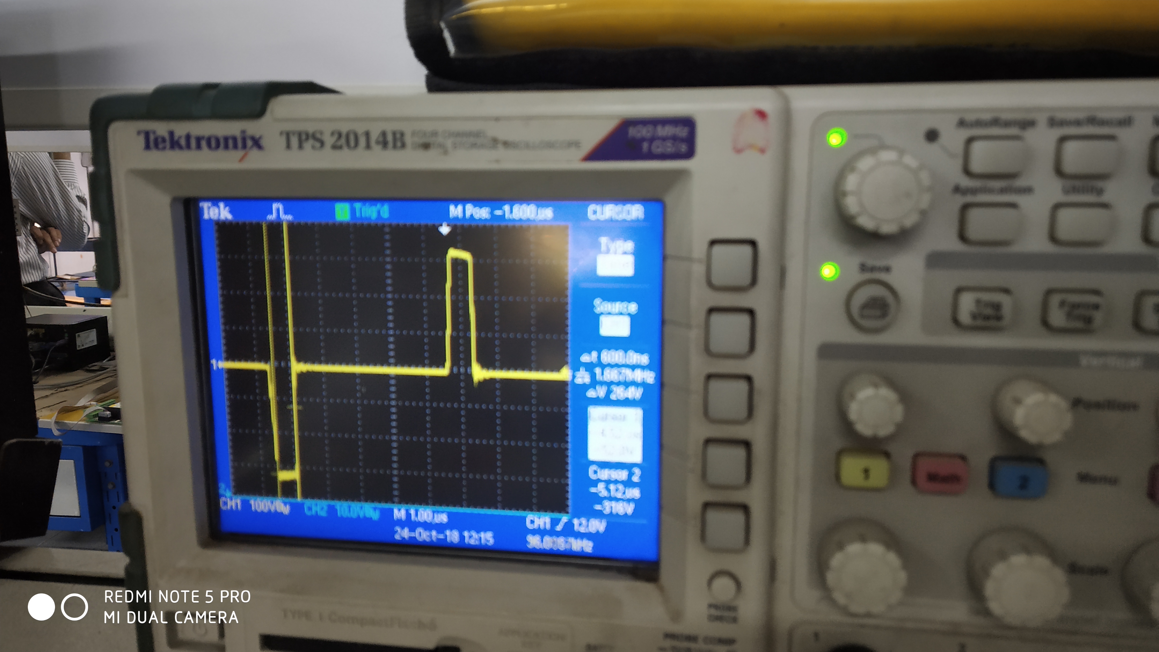

    yesterday at the time of testing of dcdc converter we come across one problem in frequency of gate drive pulses.
    i have given 12v external supply to control circuit only, not 400V dc.
    when i check gate drive pulses OUTA to OUTB, OUTC to OUTD i observed , at start pulses (frequency and amplitude) are as expected, power supply current also as expected. but after around 1 min frequency of pulses starts decreasing and after some time frequency get further reduced and power supply goes into current limit (more than 350mA current flows from power supply).
    Please help me to understand what is happening, and suggest any solution to overcome it.

  • Dear Anjana,
    Probably the power supply goes into current limit because of low frequency pulses generated by the controller U2 (UCC28950). Since this happens, the gate drive transformers T2 & T3 will saturate and draw high Vdd currents on drivers. The controller U2 should never change its switching frequency so I suspect it's an issue coming from U2 overheating. Please check with a thermometer its surface. It the temperature is too high, it might be damaged, so I suggest a replacement.
    If with a new one it still overheats, you might have one of the drivers U9 or U10 (and check also U12 and U13) damaged.
    Please let me know if that issue is solved.
    Roberto

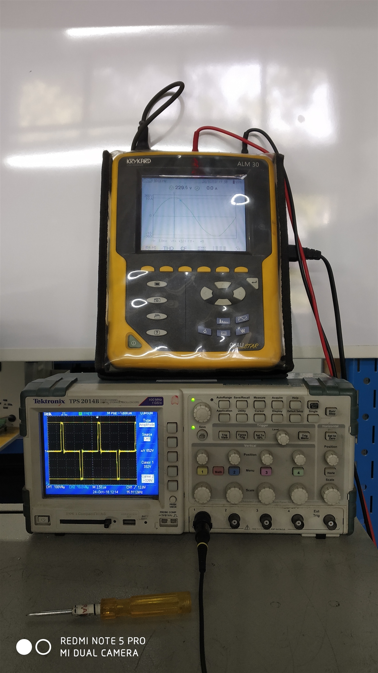

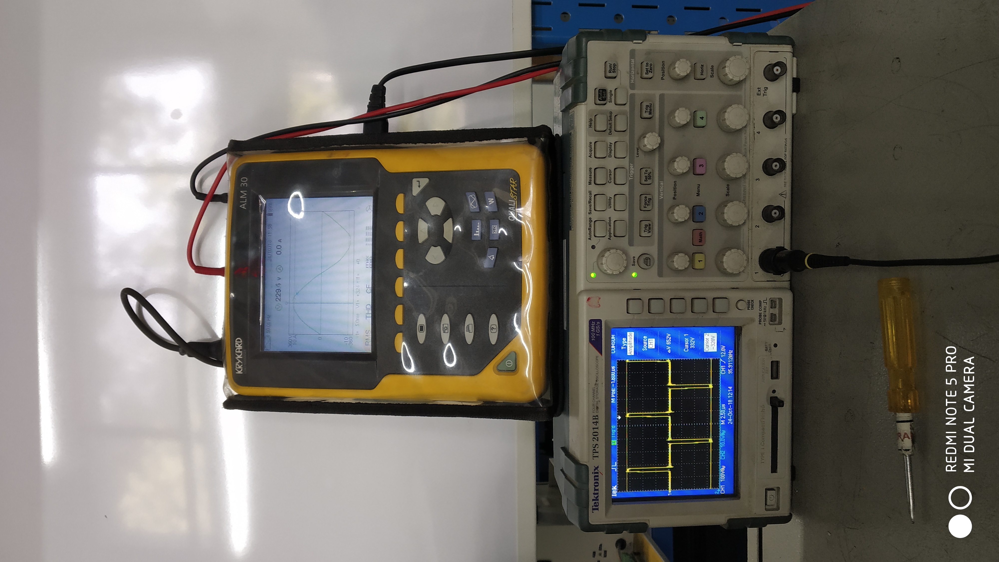

    Today at the time of testing i face the same problem of reduction in output voltage. again i load 1.5A and output voltage get reduced to 3V from 53.89V. at this time i checked CT output voltage across R34, which is as below
    VinAC=220VAC, IinAC=0.81A, Iout=1.5A, Voltage Across R34=0.052V
    I used R34=12Ohm.
    is it correct? please tell me how to calculate CT output volatge.

    The voltage across R34 can be calculated according to the following:
    Take the output current of the power supply (for example at 1.5A). Add inductor ripple current (half of peak-peak). Multiply by main transformer turns ratio (T4). Divide by current sense transformer T1 and then multiply this current by the value of R34.
    For example, if T1 is 1:100, T4 has a ratio of 5:1, the inductor ripple is 1A peak-peak, we have :
    V(R34), peak = {[(1.5A + 0.5A)/5]/100}*12 Ohm = 48mV (which is close to the value you are measuring).
    Now, in order to understand what happens to your converter, I need to know (in the actual conditions, where you have 220VAC and 1.5A load):
    1) Voltage on pin 1, 2 and 3 of U1A.
    2) Voltage on pin 5, 6 and 7 of U1B.
    3) Voltage on TP6
    Roberto

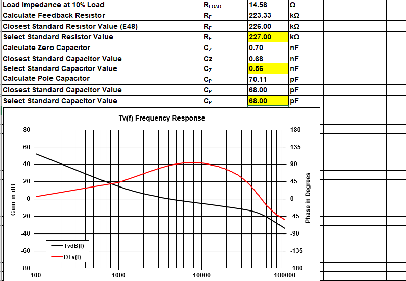

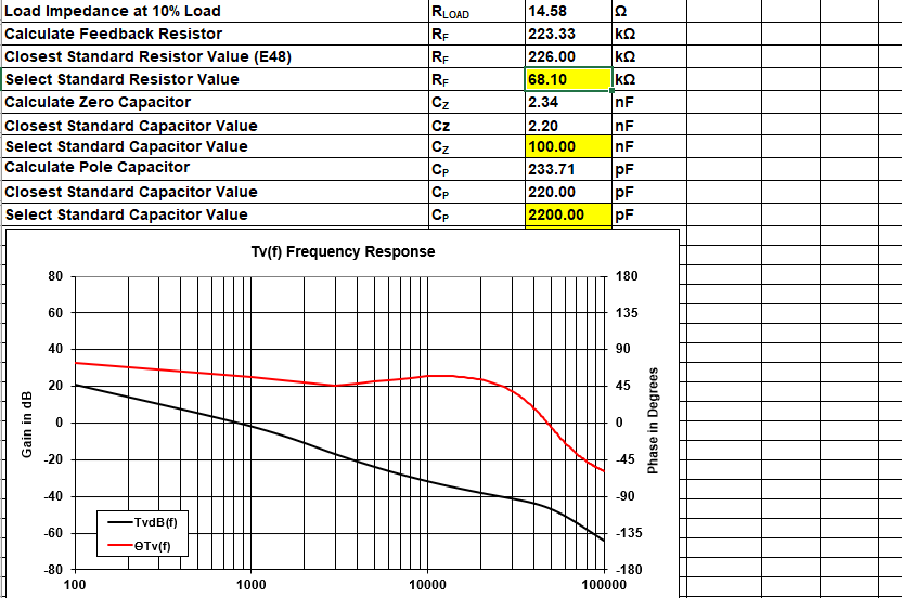

    3) when i looking in PI loop components, As per my calculations I got 227K, 0.56nF, 68pF for R3, C2, C1 resp.  i am attaching the images of bode plot for both as per my value and and as per actual values used in circuit (i used your values from pmp8740 in my PI )

    The question is: how can you have 2.3V on pin 2 of U1A if the output voltage drops down almost to zero?
    Did you connect back D1 and D2 on the board?
    What is the voltage on pin 2 of U1A when Vout drops?
    Regarding the voltage loop, in this moment it's not very important and it will be as soon as your converter is regulating your load and is able to supply the current at the right voltage level.
