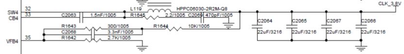

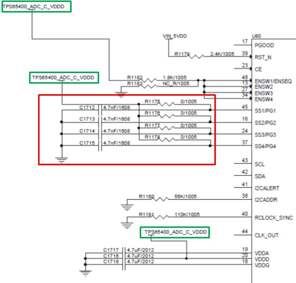

Hi team

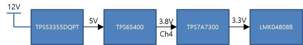

My client configured the system with the following blocks.
The circuit value of the TPS65400 are shown below.
LMK04808 does not work properly when testing -5 ° operation to chamber.
Normally, PLL2 should operate in cascade after PLL1 of LMK04808 operates.
The problem is that PLL1 operates normally at low temperature, but PLL2 does not work.
Please check that the above circuit constants are properly designed.
