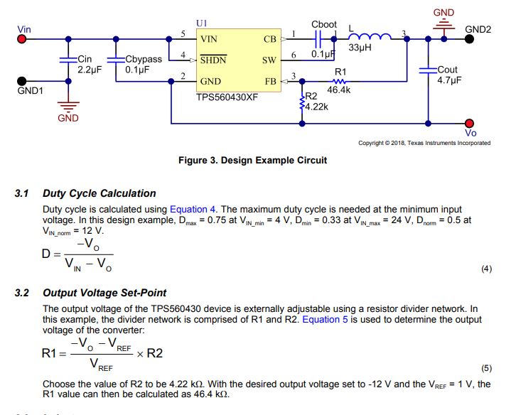

My customer started evaluation HV buck-boost circuitry with LM5160 Flybuck-boost configuration.
As primary side output Vout1 -12V is targeted, but -16V is monitored as shown in attached file.
I also attached schematic and parameters for each external parts.
Could you give some advice to solve this?
