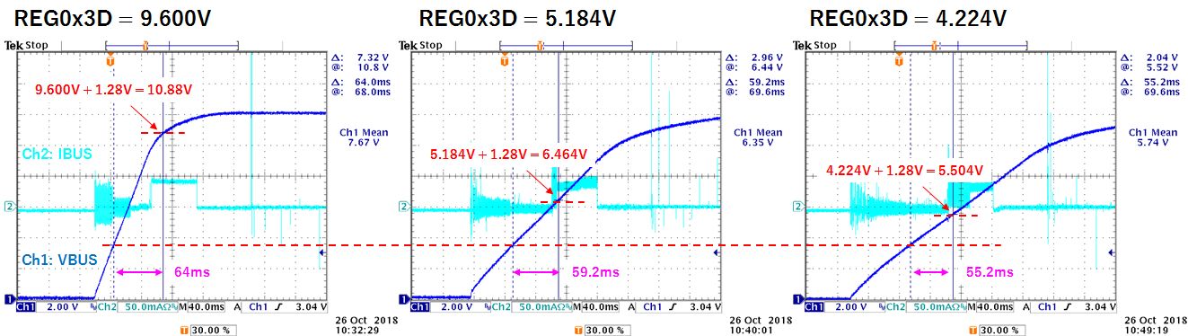

  • Hi Steve,
    I also tried to confirm the REG0x3D value with slow ramp input voltage as attached. I understand that the REG0x3D value is "Measured voltage - 1.28V" so I checked the duration from 3.5V to REG0x3D + 1.28V. Then it seems that the duration is longer than 50msec and it's varied.
    Satoshi
  • Hi Steve,
    I can take more waveform, so please let me know if you need.
