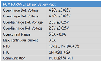

             I use the BQ24074 for charging a PACK BATTERIE with a Li-ION 3.6V 6500 mAh and a BQ27541.
When the battery is around 80% and higher in charge with USB charger (5V-2A) the pin CHG oscillate with around 1 secondes but is very random.
I have no idea why, someone could help me about this ?
