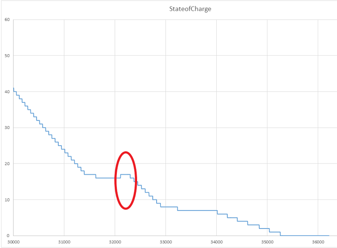

Hi Team,
as title, i find the SOC will ramp up 1% when RM/FCC adjust.
BQ27542-G1 has't RCJUMP_OK bit, it only have smooth function.
is it normal condition? or abnormal?
could we prevent it?

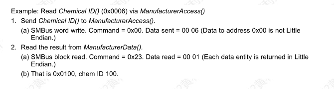

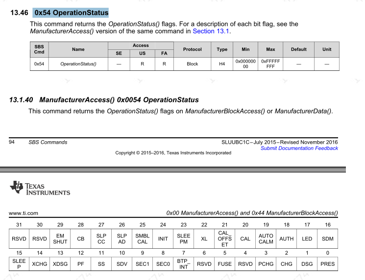

two questions ask:
1. About OperationStatus register ,from the BQ40Z50-r1 Technical Reference,i knwon that,it has two way to access,one is used 0x54 register ,another way is ManufacturerBlockAccess() or ManufacturerData(),
These two way can read the same results?
2.How to read ManufacturerAccess() 0x0054 OperationStatus register? is the same as below? First write command 0x00,data sent 0x0054,then read command 0x23?
Thanks!
Onyx,
i only ask BQ27542, not BQ40Z50.
it is others guy. i have upload log file.
you can refer it.
