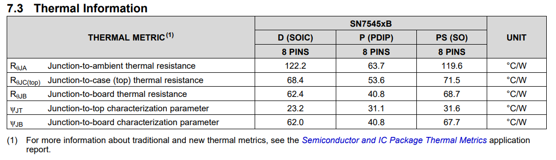

    What information are you looking for specifically? Table 7.3 contains thermal information calculations, are you looking for this information or something different?

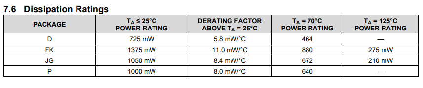

    I'm looking for "power rating (TA=25℃)" and "Derating  Factor Above TA = 25℃" and  "power rating (TA=70℃)" at 7.6 Dissipation Ratings for PS package.

    Can I calculate Derating Factor through Thermal information like θJA ?
    I think that Thermal information is based on High-k and dissipation Ratings like deration factor is based on Low-k , right?

    I tried working backwards in my calculations to extract the dissipation ratings from the PS thermal information and the junction temperature, but I was unable to get a concrete value. I also looked at our database and was unable to find any dissipation ratings, due to this being an older device.
    Based on thermal information, since the D package performs slightly worse than the PS package, you could use the D Dissipation Ratings as a conservative estimation of the PS ratings. The PS package should perform better than the results you get with the D package, but this could work as an estimation.

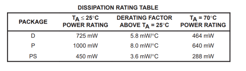

    I found DISSIPATION RATING TABLE of SN75158.
    D and P package are same information with SN75452B and it shows derationg factor for PS package.
    Does it work for SN75452B ?

  • Hi TTD,
    Yes, that will work. The SN75140 also has dissipation ratings for the PS package, and they have the same values as the SN75158.
