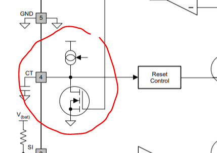

    How about the CT-pin in case PG is tied to GND?
    Can I pull CT to GND as well for better thermal performance?
    Thanks and best regards,
    B
  • Hi Basil,
    It is not recommended to tie CT to GND due to the internal current source that is used to charge any capacitor placed on the CT rail.  CT should be floated in your application.
