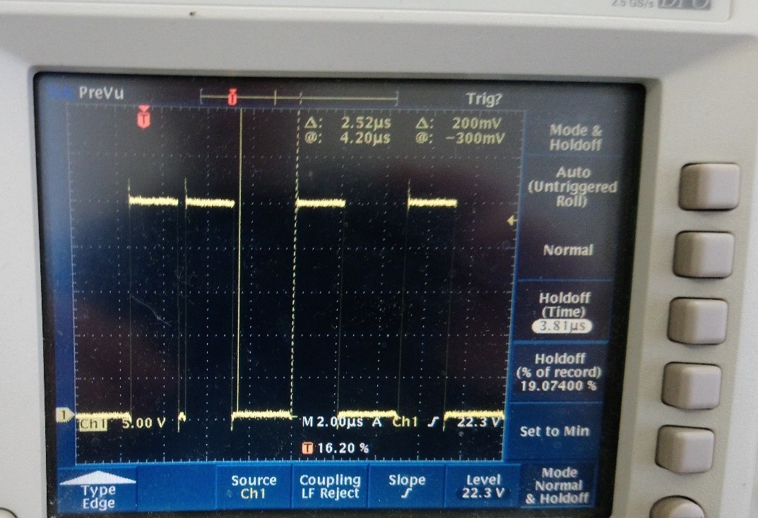

I am using the LM25117 to produce a 10A 12V converter and while most of this seems OK, I get some switching that is not 'regular'.  If I set the converter to run at 200kHz, it runs in at 100kHz with times when it tries to turn on after 5us but it then immediately turns off.  I have tried changing the Rt to run at a higher frequency but again it seems to run at half frequency with a turn on for a very short time at the correct point.
The picture attached shows this.  I think the pulse by pulse current limit is turning the FET off but I am not certain why the frequency seems to be wrong
