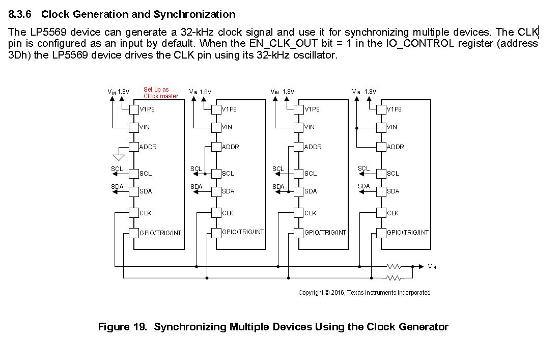

We have a PCB based on your older LP5569 evaluation board.  (4 LP5569 drivers connected to 12 RGB LED chips).  Instead of the microcontroller we are using an FT232HL USB to I2C IC connected to a computer.   We are trying to work out the programming but have noticed the following behavior:
The flashing and breathing patterns use the exact same program code on each chip. I can load each chip individually, and then set the engines to free run mode simultaneously using the broadcast slave address of 0x40 to which all chips respond. But, although I can trigger the execution on all chips simultaneously, and that they visually appear to ramp up at the same rate with visual fidelity, initially, I’m observing that the ramp down times begin to drift across the chips over time and become unsynchronized rather quickly. I’ve read the datasheets for multiple TI LED drivers and, while some have more detail than others, there is no mention of non-deterministic ramp down behavior.

  • Hi, Jack,
    If you want to use four devices' engine work together, you need to utilize CLK pin as following in datasheet:
    You can also refer to the following application note for how to use four drivers working together:
