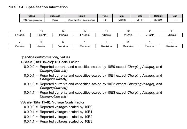

Hi.
If I want the cell capacity to be more than 32000mA on a BQ20Z655-R1, is it possible to divide by 10, by making a circuit change that reduce the voltage. into ASRP and ASRN
So that 32000mA will be 3200mA .
If possible, is this best done by a simple resistor or do I need a Opamp.
Than maximum cell can be 37 * 5000 mA = 185 Amp. = 18500 * 10 mA
If there a chip that is more suitable  for this capacity I will like to now .
Spec. The drain and charge is not more than 7000mA, And the chip need to handle 4 cells and have a SMbus or I2c bus for communication.
