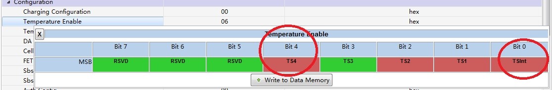

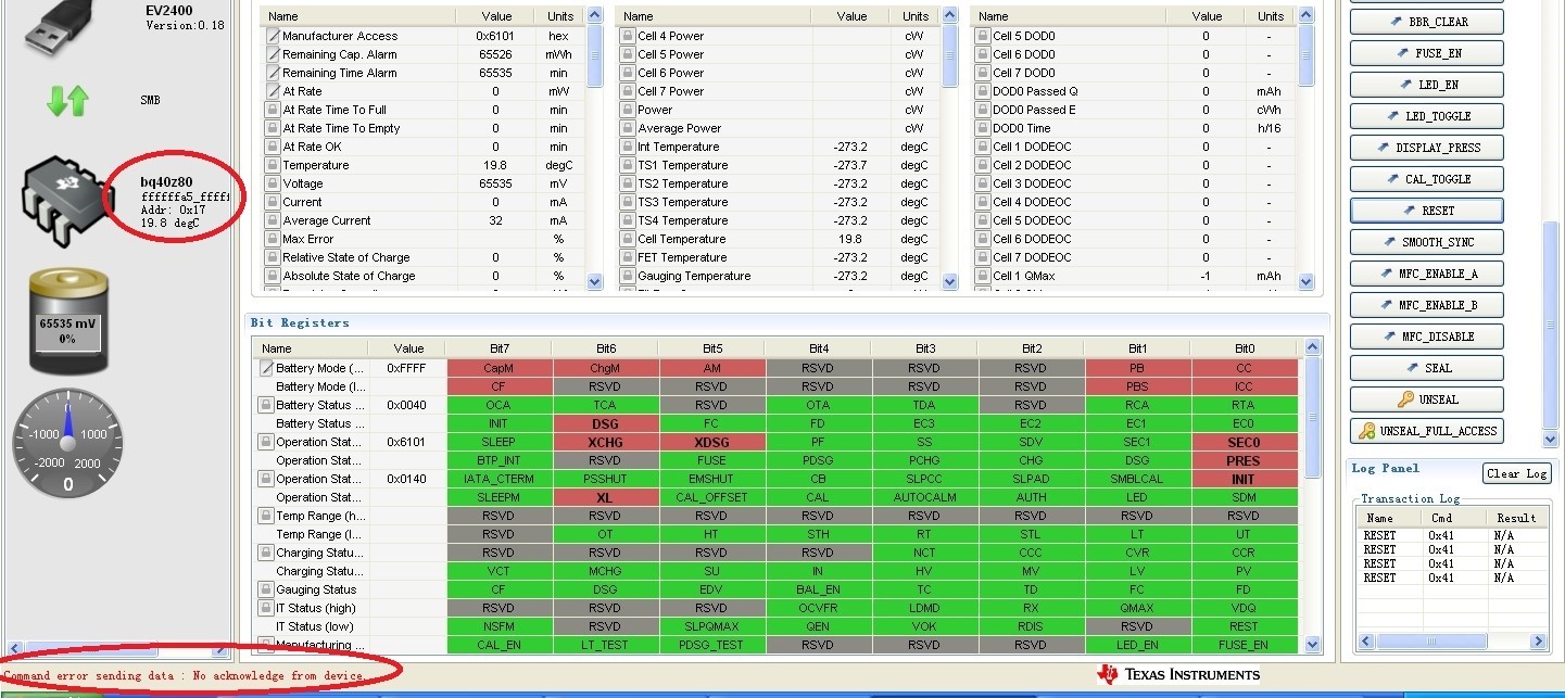

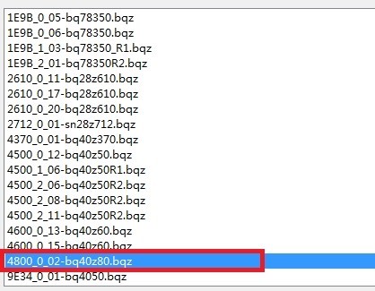

Dear TI Experts,
My customer is evaluating with 4800_0_02-bq40z80.bqz +bqStudio 1.3.86+EV2400+BQ40Z80EVM-020 , after setting TSint & TS4 to 1, the commucation will lost and can't recover. They change a new BQ40z80 sample and do the reproduction test and get the same result. Could you kindly help to give some advice about this case? Is there updated FW for BQ40z80? Thanks a lot.

    When you enable TS4, do you have a thermistor connected to TS4? Is it possible you are encountering an open thermistor permanent fail (see Section 4.22 of the TRM)? The device might be opening the FET in response to this fault condition. The other thing to consider is that TS4 and TS3 are multi-function pins so they must be configured for temperature sensing before you can enable to the temperature sensor.
    Matt
  • Dear Matt,
    Thanks for your support, you are right, my cusomer fogot to configure to TS4 before using.
