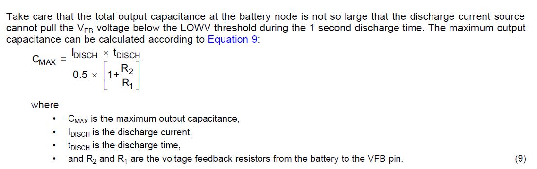

    I'm thinking to use BQ24650 part this accepts the input up to 28V to charge 3.7V battery and use a step up to 5V. A problem I have is that BQ24650 has got a battery detection circuit and it will not work if battery is not connected. I need it to work without a battery. I found that there is a way to stop the battery detection function by adding the Schottky diode between SRN and the resistor feedback. Would that work? What are the negatives of turning the battery detection function off?
    Or another idea is to detect the battery not present and turn on the main power path going to the step down regulator to 5V and supply power from there. Can BQ24650 set a logic once it detects that battery is not present?

    The BQ24650 internal battery detection circuitry can't be disabled. But the battery detection function will not work if the total capacitance connected to VBAT (charger output) is bigger than Cmax. And BQ24650 does not send out any logic for battery detection results.
