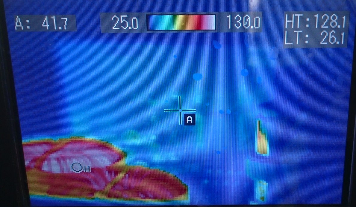

Customer is evaluating LMG3410-HB-EVM (and LMG3410-BB-EVM), but L2(inductor) was increased over 120℃ by thermograph.
User's guide is described that heatsink and airflow are recommended, but I think these idea is not critical for decrease L2 temperature.
(L2 was not decrease temperature)

  • Hi Satoshi,
    The hot inductor in your case may relate to the reasons below:
    1. The saturation current of this inductor 2300HT-151-H-RC is 7.5A, whose datasheet can be found below. With 5A average output current plus the ripple, the core may be saturated.
    www.bourns.com/.../2300ht_series.pdf
    2. Higher rms current will increase the winding loss, increasing the winding temperature.
    To solve the problem, we suggest you to change a different inductor here, or increase the switching frequency to lower down the ripple current. 100 kHz can be a good trial. The inductor temperature is close to 100C with 100 kHz.

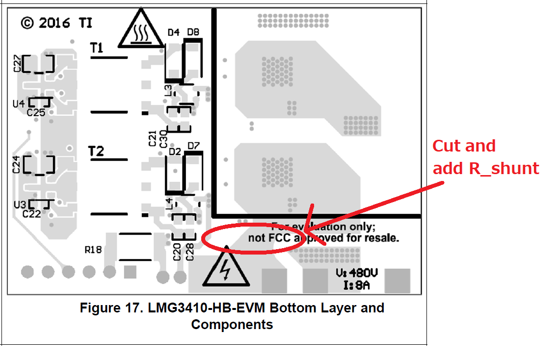

  • Bingyao-san
    Sorry for additional question, please let me know about two points below for snou140a User's Guide (Page 17 Layout);
    ①About your idea for measure Low side FET with current shunt, is below measure and connect R_shunt point correct?
     If incorrect, please let me know about correct point.
    ②Is below point isolated from PGND?
    Satoshi
  • Hi Satoshi-san,
    For your first question to add the shunt resistor:
    1. The inner copper layer 2 also has the copper to connect the device source to the GND. If you want to cut the copper, you also need to cut the copper in the inner layer 2.
    2. The shunt is needed to added between the low-side FET and the bus capacitors, not just the GND terminal. The position pointed only cuts the connection from the FET source to the GND terminal, which will not give the low FET current information if the shunt is inserted.
    3. This method (cutting the copper and inserting a shunt) introduces large parasitic inductance into the power loop, which would induce large switching overshoot/undershoot. The results would not be true/optimal performance of GaN. It is suggested to build a new PCB with nice layout to include the current shunt
    For your second question:
    The termination you highlighted is connected to PGND.
    Please let me know if you have more questions.
    Thank you,
