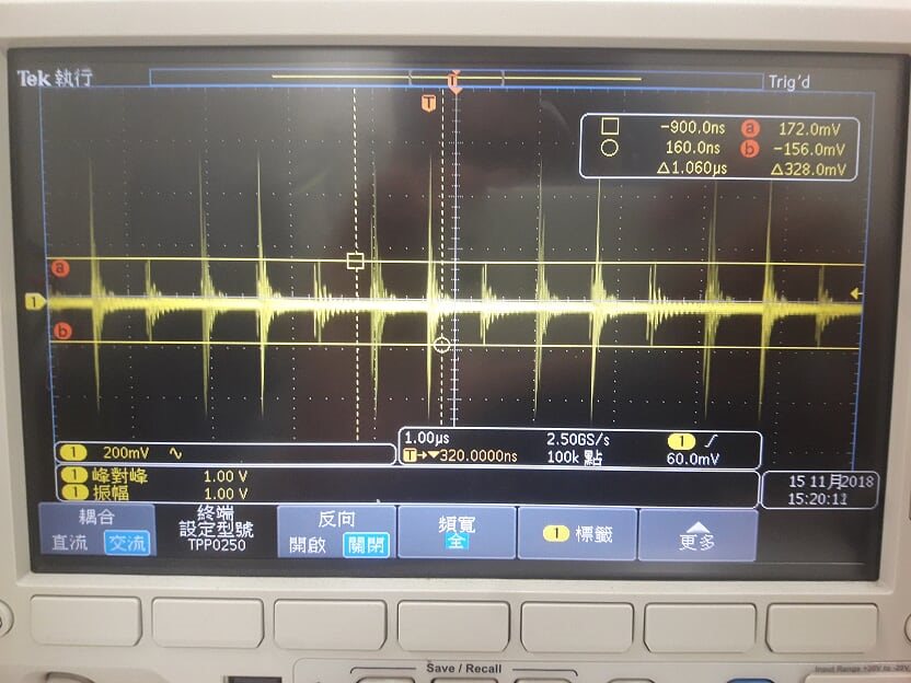

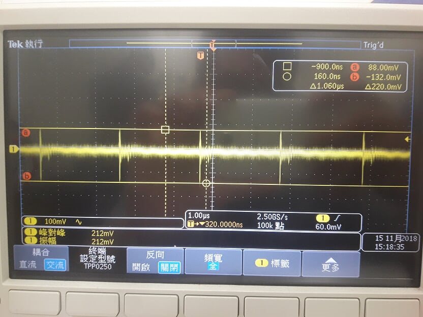

where the 1.8mhz build? i only need 500Khz output

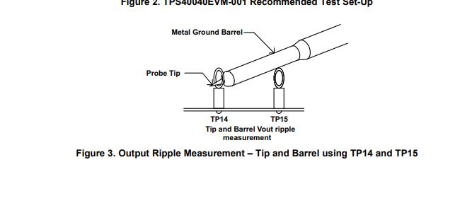

    How are you measuring the output votlage? Are you measuring with the tip adn barrel method?
    One possibility is that high frequency noise is coupling from the input of the converter to the output of the converter or from the switch node to the output. You can also probe the input and SW node, one at time to check for any noise or ringing.
    Katelyn
  • what is  "tip adn barrel method"?  , i only use oscilloscope to measure the voltage , then get this wave.
    so if is the high frequency noise , how can i fix that ??? please tell me thx
    Please see the image below of tip and barrel:
    This is a way to measure with the scope probe.
    If it is high frequency ringing, you want to optimize your input capacitor loop.  You can also add a high frequency bypass capacitor directly next to the input and/or at the output as well.

  • hello,dear Katelyn ,i use tip to measure the waveform,

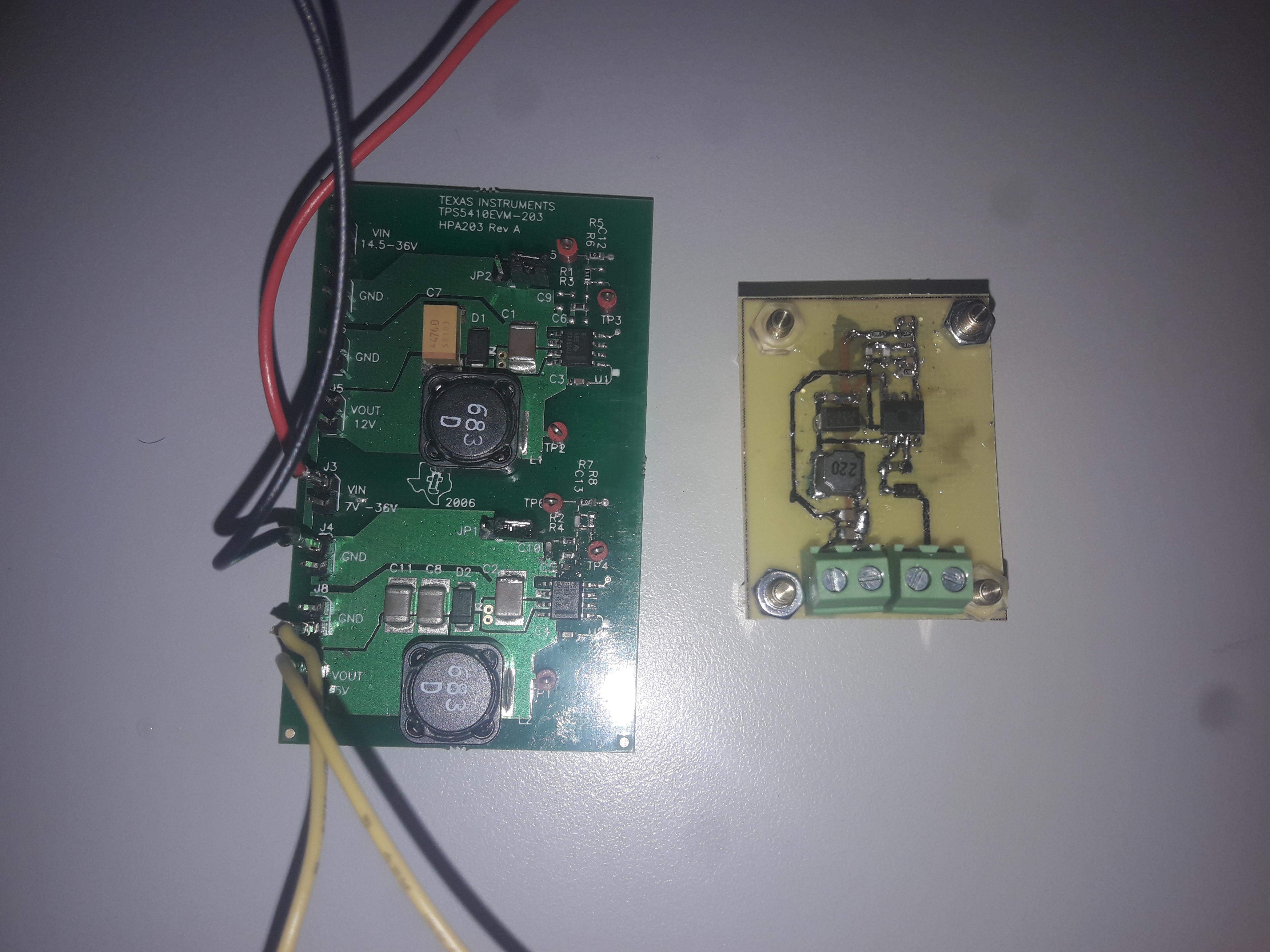

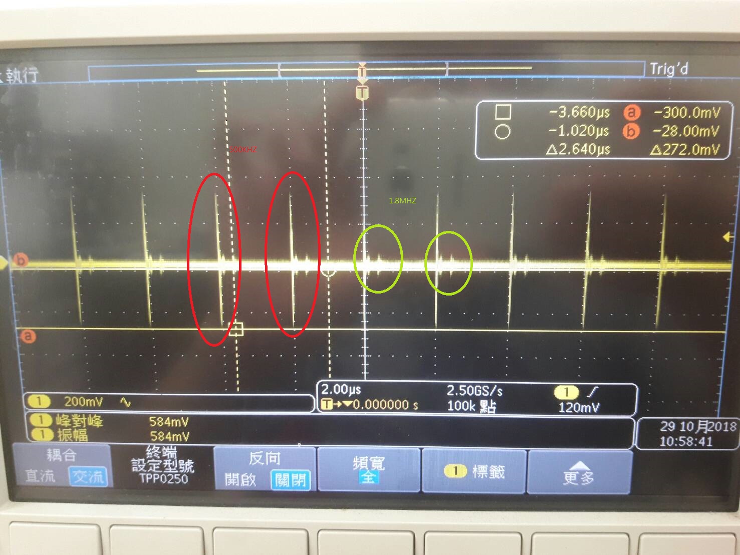

    and I am compare the EVM board and my design board. when I measure and i don't use
    tip and barrel to measure and I didn't see high frequency like my post first picture.like
    green part 1.8Mhz.
    but i design board if i don't add R-load on 3V3D and 3v3Gnd the high frequency dose not appear.
    but if i and the low R-load (maybe 10ohm~30ohm) it will appear the 1.8mHZ.
    i have test for 10ohm,30ohm,and 330ohm, because my circuit R-load near to 330ohm
    so I add the 330ohm on my circuit.but it still can't resolved this problem . it appear on 330ohm for high frequency.
    as the same value of resistance on EVM . it also not appear.
    so this is layout problem?

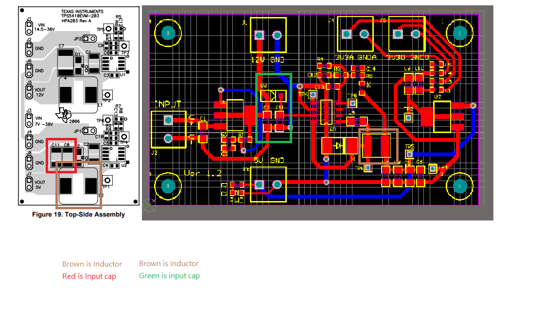

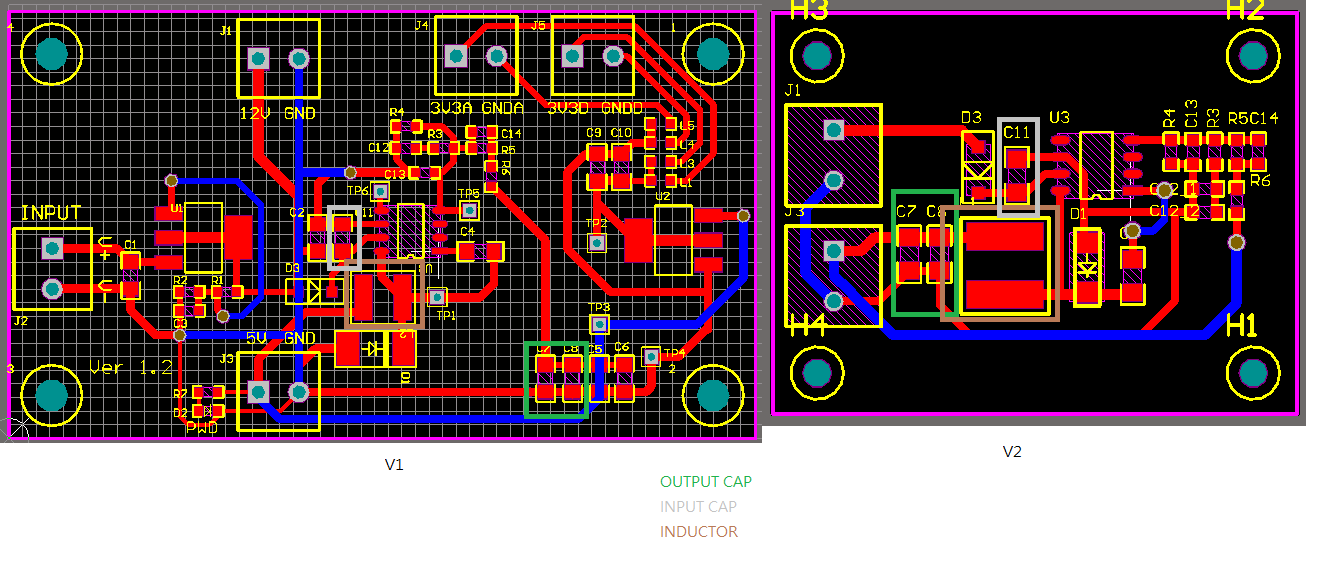

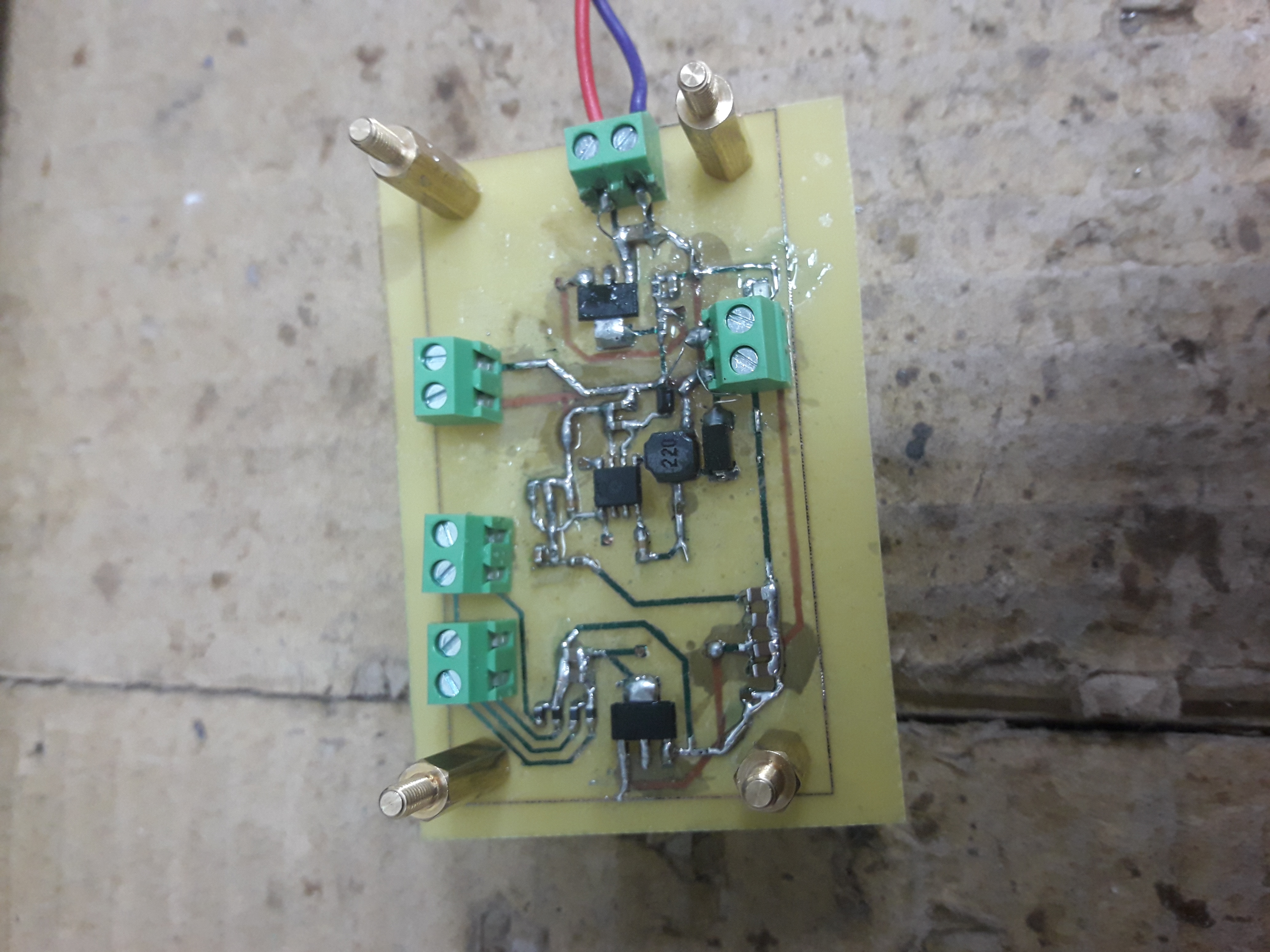

    this is my layout picture, as u document file say that the input cap and inductor distance maybe cause HF noise.
    it is 1.8mhz build reason???  So Other than this it only has improve layout to reduce noise  or it
    maybe has another method to  reduce such change or add some circuit componet to solved?
    In regards to the measurement method, you want to understand the true level of noise.  The noise may be there, but it is important to understand the true level that you are trying to filter out.  With a bad measurement technique, noise can couple to the probe and amplify the noise of the design.

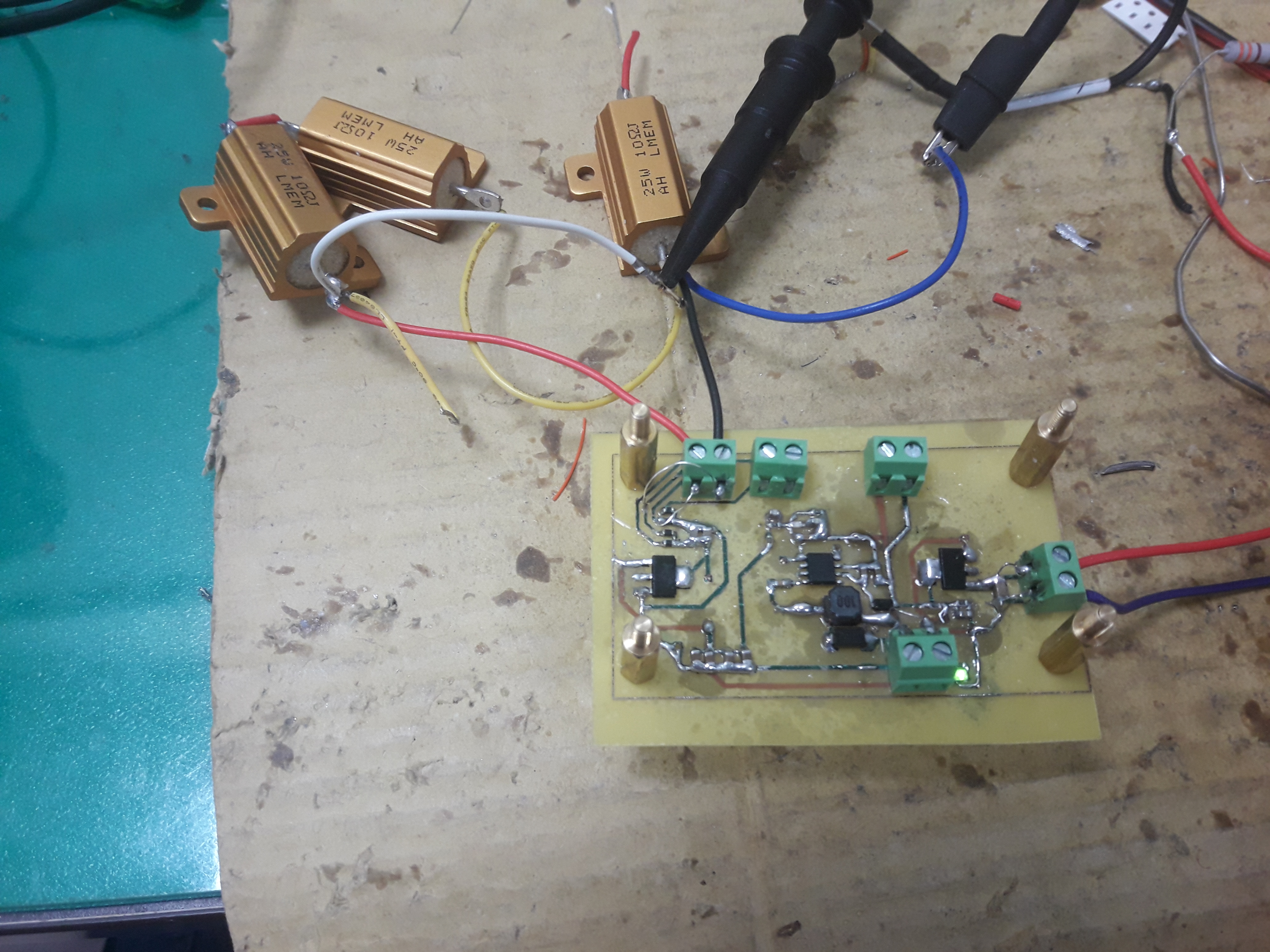

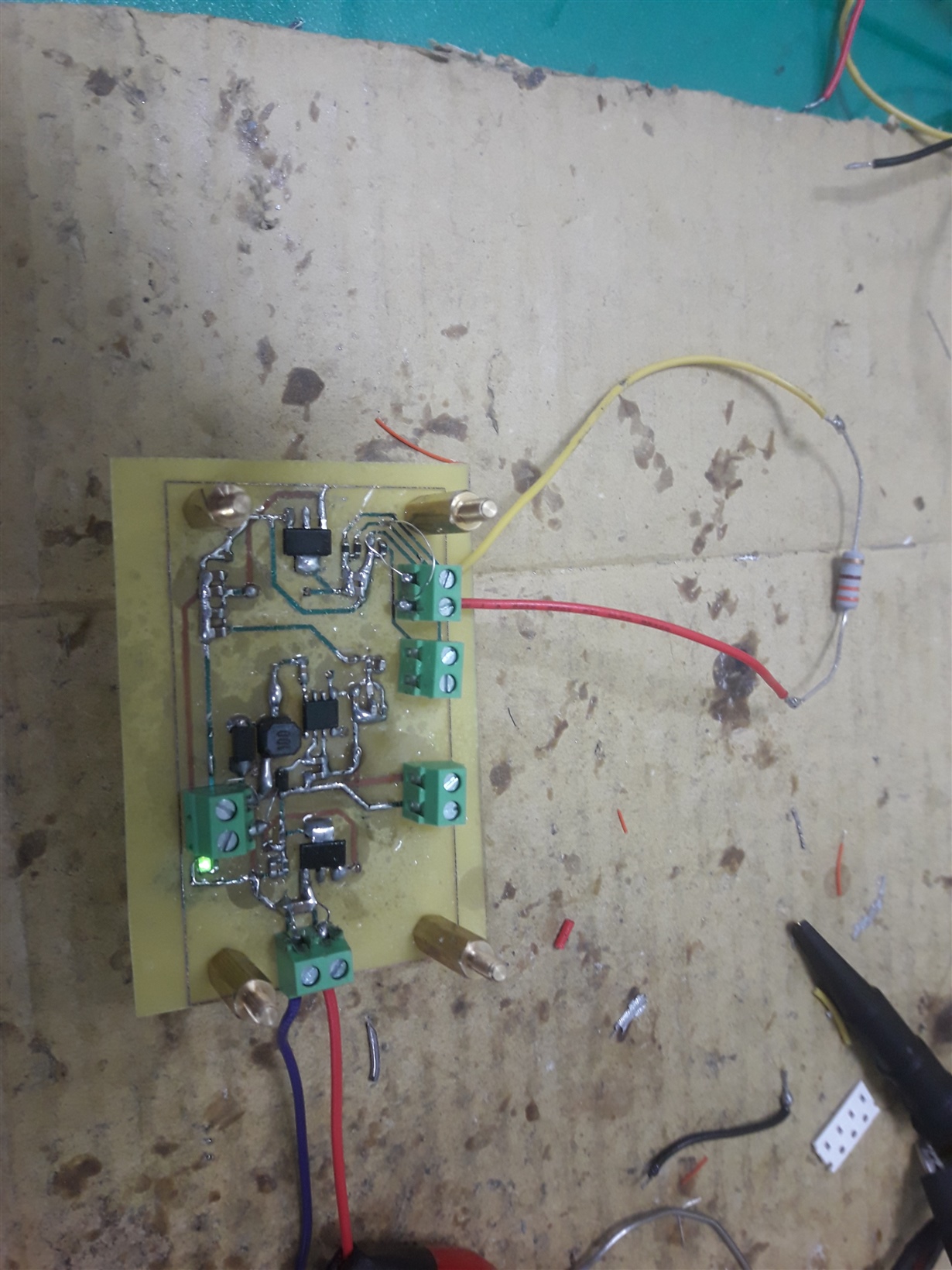

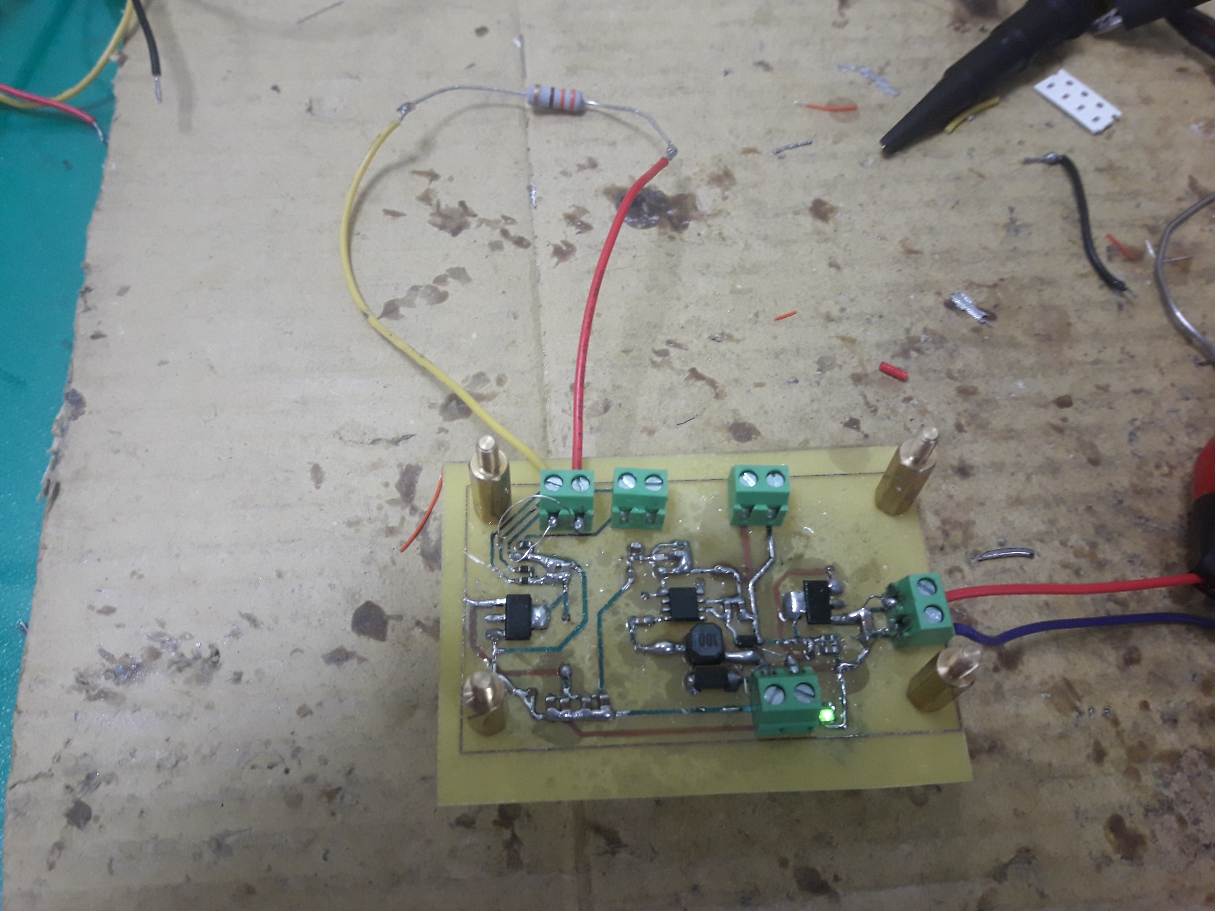

    Also, how are you adding the resistor?  Is this directly on the board or through long wires?
    I think it is very possible this is a layout problem.
    Please see my recommendations for your layout:
    1. Move C11 as close as possible to the device.
    2. Add a ground plane across the entire bottom layer of the board and entire top layer of your board.  This will improve the return path of all signals.  And will also provide an improved design for dissipating heat.
    3.The inductor, boot capacitor, and diode need to be in as small as loop as possible.
    4. Move the output capacitors directly next to the inductor.
    5.  Follow the example below for routing your resistor divider.

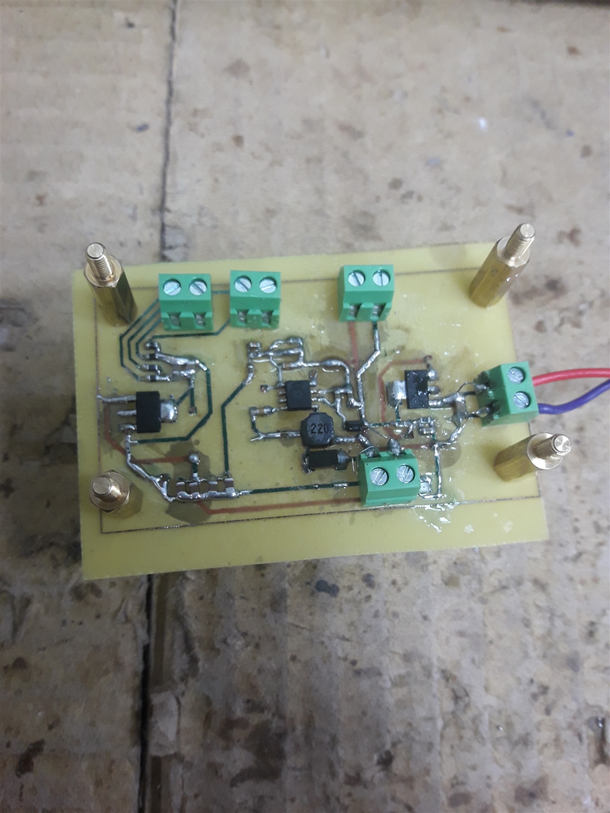

  • Hello , recently I am busy , so i didn't reply at first timed.
    before u reply me from Nov 16, 2018 1:32 AM.
    i have test the 2 vesion of circuit.
    like the picture
    the v1 is input cap and inductor close to tps5410
    the v2 is input cap , output cap inductor close to tps5410
    then i compare this two board. the wave is similar.and the high frequency noise is reduce.
    so i think that the almost problem is like u say it maybe is inductor and input cap position build.
    it it not related for output cap. so maybe i design the circuit i will ignore the output cap position.
    such like eliminate. it almost about 70~80mV.
    then i compare evm board that i find the evm board is same too.
    so i think the high frequency is resolved a part of but not perfect.

    if add the Light load resistance (330ohm,the power is output 0.019A) like this , the evm board and my v1 board waveform is like this
    that seems it is perfect and OK.
    but if add the Over load(which R is i think high load, high current 30ohm,the power is output 0.79A)
    please ignore the measure method,but the evm result is the same result so i think my circuit is almost perfect for compare to evm board.
    this result is normally?
    the problem is confuse me,and seems high challenge to eliminate the high frequency noise,such like top question for yellow part and red part.

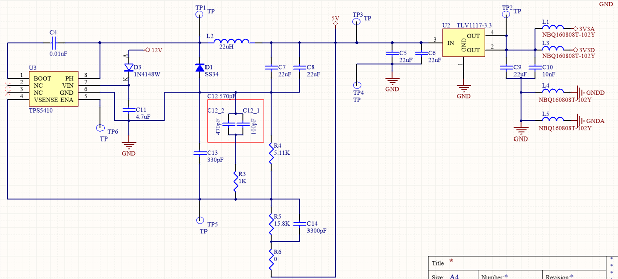

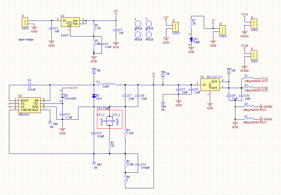

  • Sorry,I forget post schmeatic
    please look Component J5 that is where i add load
    Thank you for sharing this additonal information. Can you please clarify which board/design you are using for both scope waveforms.
    I think that is important that you place the load as close as possible to the output (eliminate the wires as much as possible), and measure the output ripple at the output capacitor with the tip and barrel method. If you use the ground loop, this can pick up different noise at different times. In order to get a consistent measurement for accurate comparison, I recommend using the tip and barrel method at the output capacitor.
    Also, when you spin this board, you will definitely want to pay attention to the input capacitor and output inductor. I would recommend that the output capacitor can be third priority, but you do not want to let this capacitor move very far in distance from the inductor.
