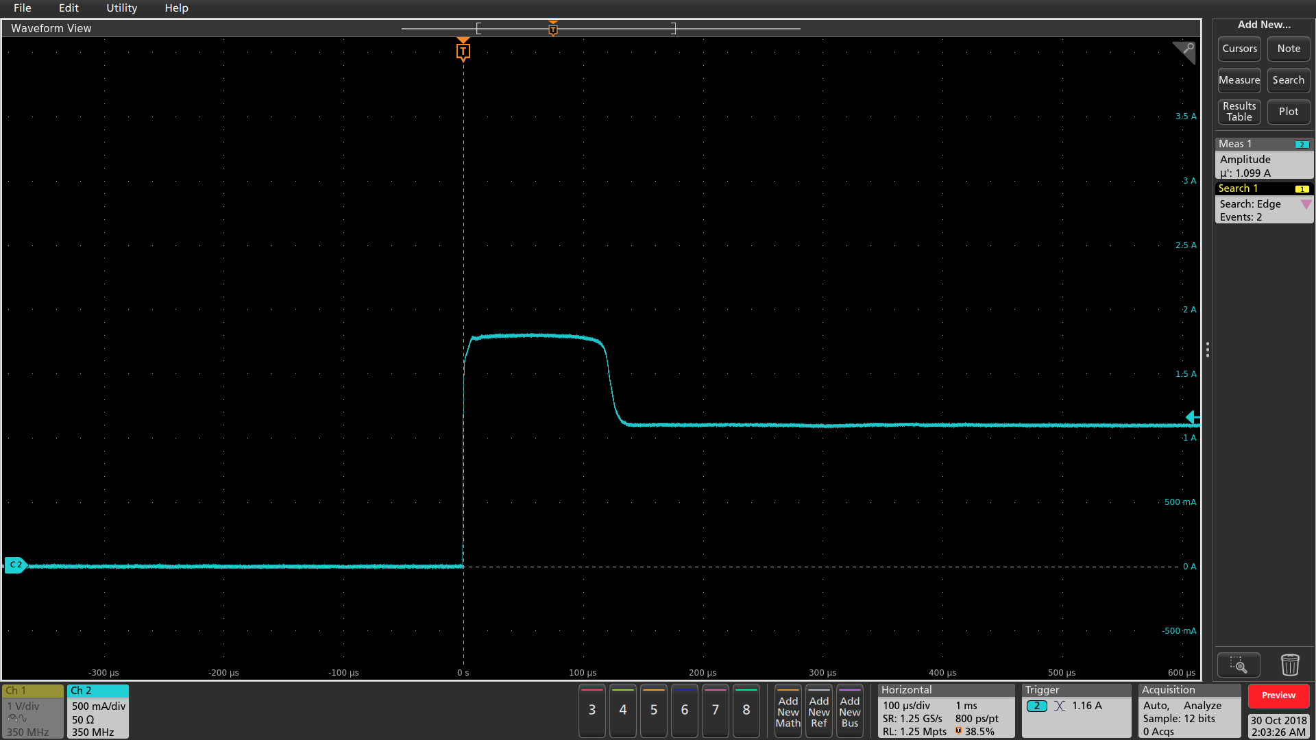

Hi team,
During short circuit, the SC current is 1.9A max which is much higher than teh OC current of 1.3A.
My customer would like to know what is the typical time that the current is above the Ios?
