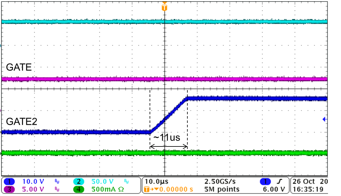

(1) When testing GATE2, I found the really sourcing current is 5mArather than 50uA, please kindly comment on this.

  • Hi Rakesh,
    I did not directly test sourcing current. Instead, I calculated it, please see waveform below. When test 23523's EVM, in terms of GATE2, it takes ~11us for csd19532q5b Vgs to reach 15V. In addition, csd19532q5b's Ciss is 3.7nF. Calculate current using C*dv/dt, approximately sourcing value is 5mA rather than 50uA.

  • Hi Wenhao,
    The effective capacitance at GATE2 will be lower than 3.7nF as the main FET is already ON and VDS=0V. Ideal way to measure is place a 10nF at GATE2 and capture the waveform.
