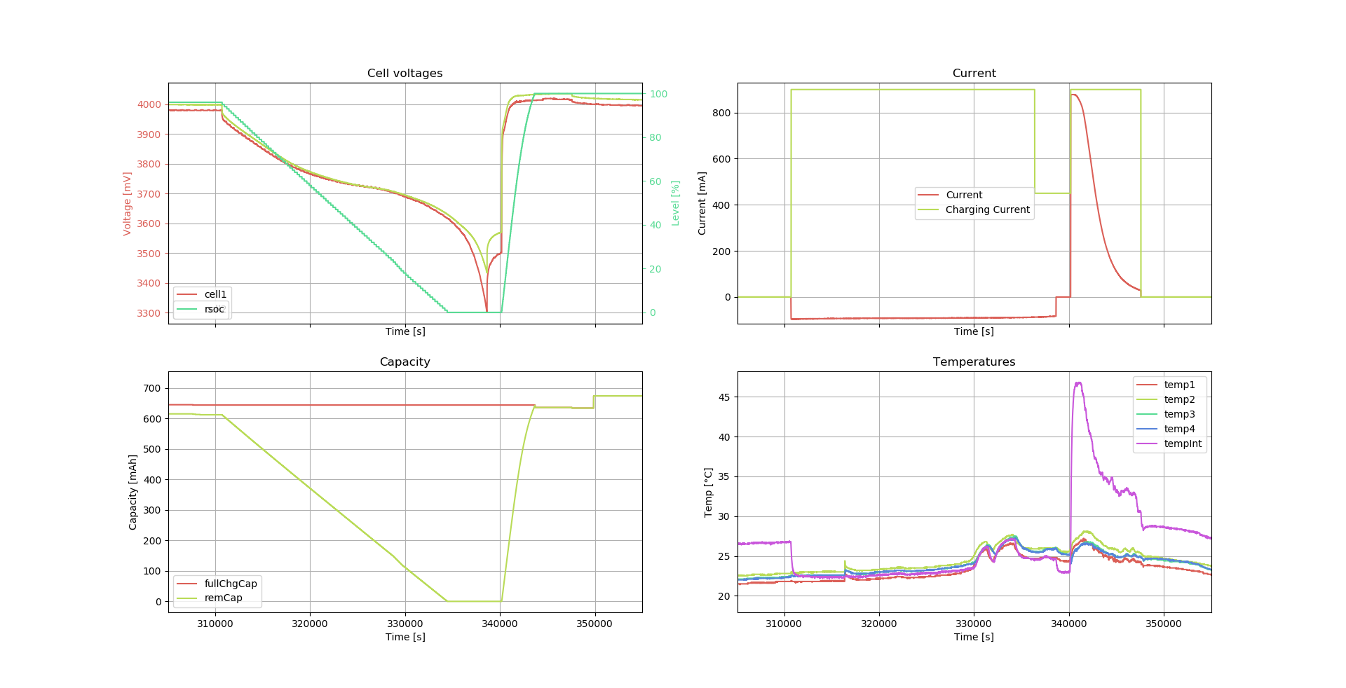

Here is a plot showing when the charge stopped:
And for reference a similar plot when the charge didn't stopped:
So my question is basically that: What exactly are the conditions for CTO timer to reset? Is this a buggy feature that I should avoid?

    However, I do see that the device temperature is rising very fast during charging. Are you sure that you are not seeing an OTC fault? The default setting for the OTC protection is 55C. I do not see it go to this temperature on your data graphs, but do you see any samples that reach this temperature (the default delay is only 2 seconds for this fault)?

    Thanks for the input. For your concern about temperatures, it is only the BQ40Z50 internal temperature that goes up, cell temperatures (physically measured on the battery pack with exported ntc) don't go above 30°C and in "configuration - Temperature Enable" I removed TSInt (value is 0x1e).

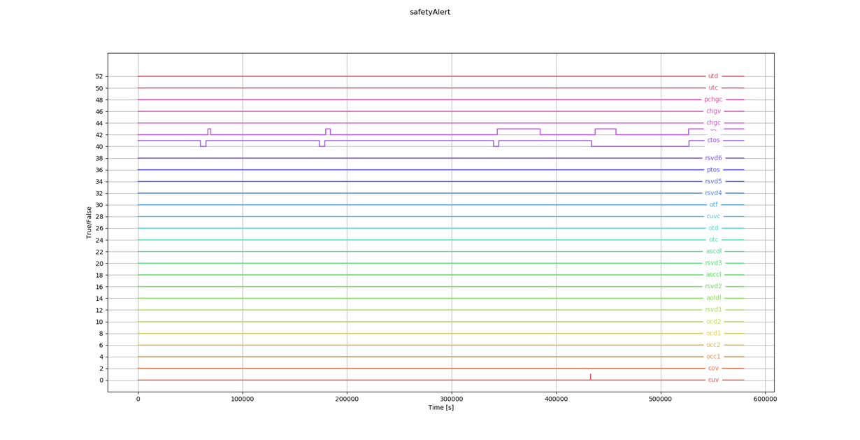

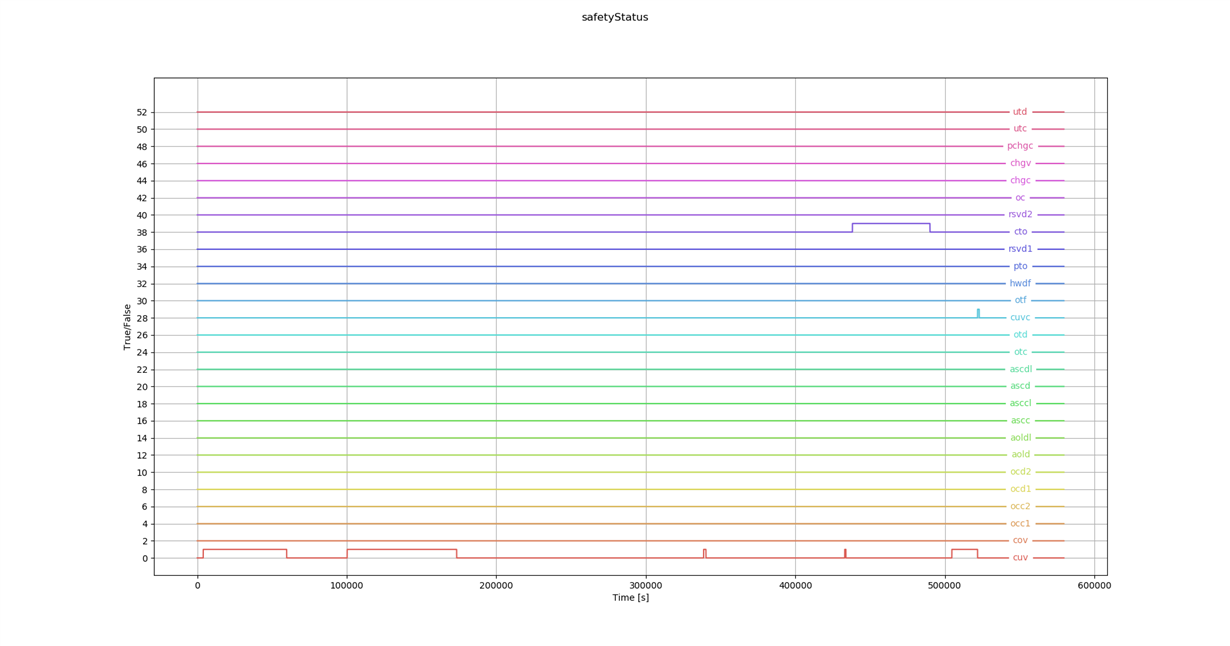

    Here similar plots showing the safety status and alert flags. We can see that this is actually the CTO flag that gets triggered and not the OTC.
