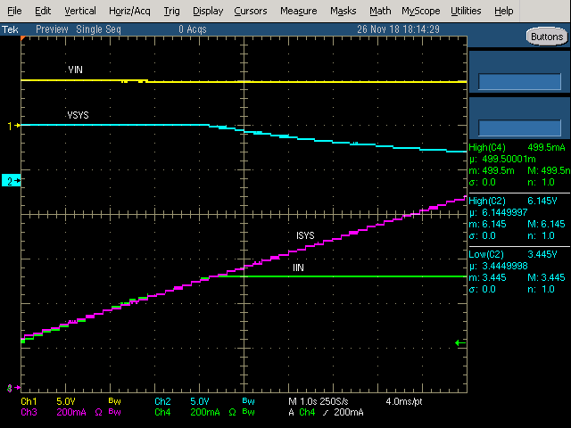

  • Hi Tim,
    Procedure:
    1.  5V on VIN
    2.  No battery attached
    3.  Jumpers configured for 2 cell
    4.  With BQStudio, disable Watchdog, set input current register = 600 mA
    5. Increased ISYS with CC mode Eload.  Scope capture attached
    6.  Using BQStudio, read IIn with ADC.
    **Reads Back 500 mA instead of 600 mA as set**
    So I also see a discrepancy between the input current register and the measured input current limit, but the ADC is in good agreement with the scope capture and the input current limit register as reported by BQStudio is only off by 100 mA (I say "only" as compared to your case in which you are not seeing any current limiting up to 2A).  Also, as expected, I see the input current limit when 500 mA is reached, but the output current continues to increase.  This results in a voltage drop on VSYS.
    So, while I do see the offset discrepancy you reported, I am unable to recreate your issue of no current limiting.  Can you tell me if my procedure above differs from your test scenario in a significant manner?  Perhaps you can provide me with your boards schematics or your register dump?  Clearly something is different in either hardware or register settings between the system I am testing and the one you are, but without this information I have no way to determine what that is and therefore no means of resolving the issue.
    Since issue cannot be recreated with the current information, I am going to mark the thread as resolved.  You may reopen by clicking the "this did not solve my problem" button.  This will reopen the thread as unresolved.  If you would like to reopen the thread for continued support, please include some of this requested information (register dump or schematics) so that I may try to determine what is different between our two systems.
