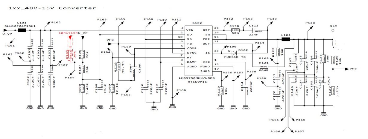

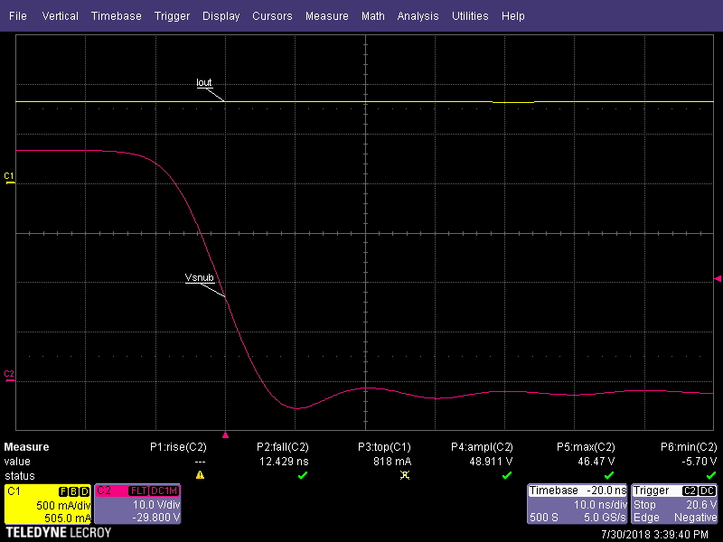

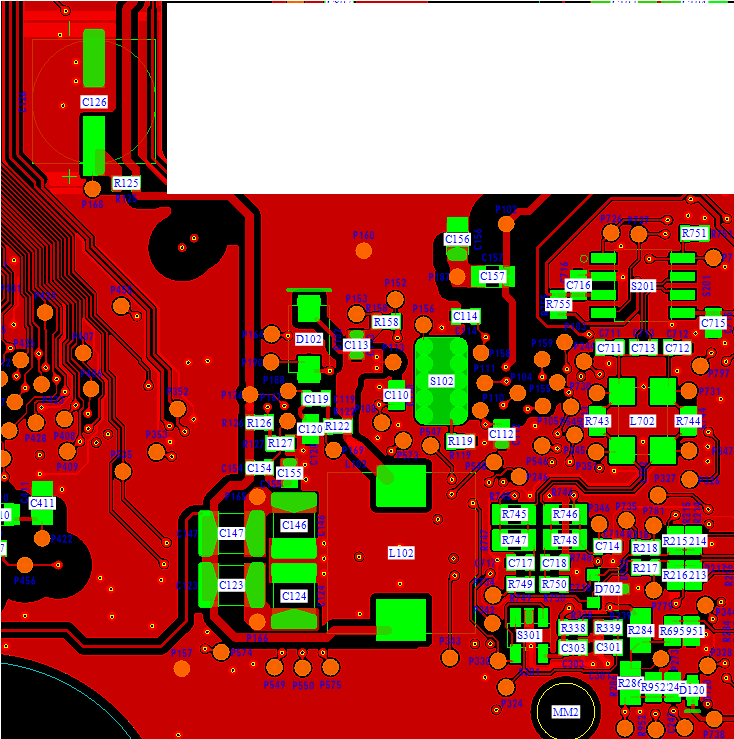

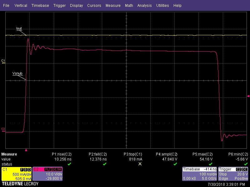

Hope you are doing well. I have a question regarding the negative value for LM5575 3.3V output at PRE and SW pin shorted together. The absolute maximum value mentioned in the datasheet is -1.5V.  The question is that if i put a contstant load at the output of 3.3V so the steady state value is must hold?
PS: i am using 10 ohms and 940pF for my snubber.
